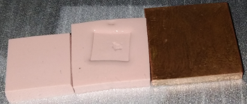

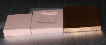

There was a question about the exact distances between the chips and the heatsink on the RT-AC86U.
Well, 1.9 - 1.95 mm for the CPU, 2.9 mm for the radio chips (both 2.4 and 5GHz appear the same thickness). The CPU has its own mini PCB and stands about 1 mm higher than the radios (which are soldered to the router's main PCB).
The thermal pads used are:
- 2.5 mm on the CPU (and it's a little squashed);
- 3 mm on the radios.
Or at least those were the sizes on my unit.
FYI, the effect (t before vs t after) of this replacement alone was 24 C, +/- 3 C (2.5 mm original thermal pad to brass shim).
... And some pictures (downsized quite a lot as the forum wouldn't let me upload original size):
- The CPU;
- The main ICs on the board, starring left to right: CPU, radio chip with a thermal pad still on it, bare radio chip;
- The CPU already coated with thermal paste and covered by the 15 x 15 x 2 mm brass shim;
- A radio IC thermal pad (3 mm), the CPU thermal pad (2.5 mm, visibly deformed), the replacement brass shim at 2 mm.
