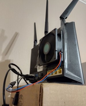

I taped small 6mm magnets into the cpu fan holes with the tape on both sides of the holes (drilled out the holes a bit). On the router side I taped small steel washers to the router with electrical tape. The fan is attached via magnets. The 12V cpu fan runs at 5V, the current appears to be 10 mA yielding 50 mW of power consumption out of USB3 port. I also stuck a sheet of tulle fabric between the fan and the router for dust control. The fan is pushing air into the side of the router as per original design, with the air exhaust on top.
Yearly electricity consumption is 0.05W*24*365=438W/h ~ $0.06 . Definitely worthwhile insurance!

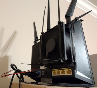

Single fan - and my temps are perfectly under control, CPU is the 1st number below.
Nov 19 10:30:00 RT-AC86U-9988 Temp: 47.9 38.5 47.5 ; Mem free: 29140 KB; Swap used: 31260 KB; sda1 wrote: 1381.25 MB
Nov 19 10:45:00 RT-AC86U-9988 Temp: 48.8 38.5 48.0 ; Mem free: 33744 KB; Swap used: 31256 KB; sda1 wrote: 1404.11 MB
Nov 19 11:00:00 RT-AC86U-9988 Temp: 48.3 38.5 47.5 ; Mem free: 26632 KB; Swap used: 31252 KB; sda1 wrote: 1425.08 MB
Nov 19 11:15:00 RT-AC86U-9988 Temp: 48.3 38.5 47.5 ; Mem free: 32336 KB; Swap used: 31300 KB; sda1 wrote: 1446.58 MB
Nov 19 11:30:00 RT-AC86U-9988 Temp: 48.3 38.5 47.5 ; Mem free: 30516 KB; Swap used: 31256 KB; sda1 wrote: 1463.03 MB

I swapped to a AX92U from AC86U. I was using a fan for the AC86U and that brought the temps down to 65C from like 95C or something. Only bad thing is fur will clog the fan easily if you have pets around :). Fortunately I have a filter next to the fan so the big particles get trapped in there but have to make sure to clean it. One thing I learned is that with each ethernet LAN port plugged in and connected, that will also raise the temperatures so if you have that going, you may want to consider a network switch to minimize using router ethernet ports.
