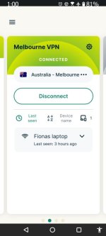

It's just a VPN router for dummies, like me, it just makes it easier to sort what you want to go through a VPN server and what you don't. I suppose it's based on the stock firmware that comes installed on the RT AC 68 U . It just makes it so easy, you set up columns eg US VPN Australia VPN no VPN and just click on the device you want and drag it to the column of your choice. My main reason for buying it is I can set up my Roku devices directly to it . I know you guys can direct what you want to go through a VPN tunnel and what you don't want but I needed a second router to replace an old tp Link so I bought this. Kill two birds with the one stone,so to speak. I'm no Tech expert I'm sure you know by now so it was just the easiest way for me. PS besides I wanted a new toy, that is what the column,s look like and you can make as many as you want I think

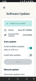

When you go to the GUI, what does it say at the top for firmware version?
It may be convenient, but older Asuswrt version missing many security updates.
It replaces the stock Gul The firmware is express VPN,s firmware . I thought,as it's an express VPN firmware and I have everything going through a VPN server it would be safe ? It is not the main router I have a RT AC 88 U as the ppoe gateway and the 68 U plugged in to a LAN port . I was surprised when I flashed it because I assumed that, like Merlin firmware,it would use the stock Gul and enhance it but it totally replaces it. Now that I've had a couple of days to play with it I like it . It's more like an app now as in I get the same speed I get using the express VPN app for Android phones and it just works on all the streaming channels I use without any hiccups or being detected ( up yours Netflix) . When streaming using an express VPN location on my RT AC 88 U from time to time I get the dredded error message,, you may be using a VPN or proxy server turn it off and try again,, not with the 68 U and the express firmware
