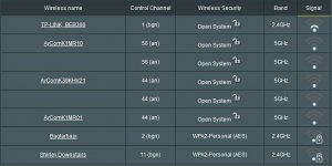

by the way...attached is the result of my site survey scan

Regarding the site survey, it shows the lower channels of the 5 GHz band are congested, probably the router scales down from 80 MHz to 40 MHz or maybe even 20 MHz, that will really slow down throughput.
The Wireless Log of the router will tell you.
