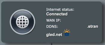

I have static IPv4 and IPv6 addresses from my ISP, so I'm not sure / aware that there is a short term lease that is applied to either. Edited image below for Network Map > Internet Status
