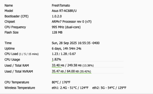

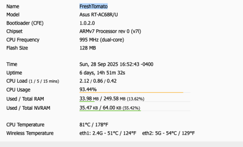

FreshTomato firmware, has solved the issue with RAM usage. In my extensive testing and daily usage, there is only an additional 2MB of RAM usage while moving files or accessing videos to watch from external USB drive.
Here is a screen shot. Im currently moving a movie to external USB drive from MacBook Air via wifi and watching a movie from the same external drive attached to the router.
Thus the router works flawlessly as NAS/File Server.
Second screenshot, shows RAM usage while router is idling and there no activity of any kind.
