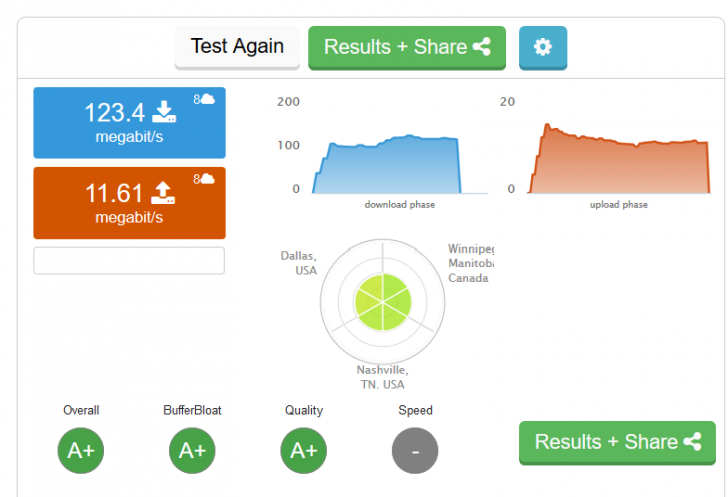

@ttgapers these test are wired correct? Just by chance, do you get same scores on wireless testing? Thanks!
That last test was from my Wireless (AC/5Ghz) connected Surface Pro 4.
I can send a sample from a wired machine if you like...
Wow...yes would be cool, however, if you're getting these scores on wireless already, i'm sure they def won't change on wired!
I was amazed when I saw the score as well. I want to keep this running for about a week. I have services I host internally as well, so I should get a good load profile with the 12 hour test as per bufferbloat.net. Gonna leave that running today for the full 12 hours....
Definitely keep us posted.
