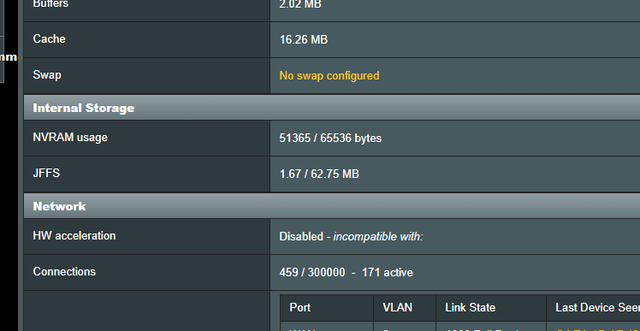

Dear all.
After a hard reset and a new asus firmware and then the latest Merlin i do have this NvRam:
Looks not a very great clean up
Only is this a normal value?
ngth(), $0 | "sort -n -r"}' | cut -d"=" -f 1 | head -n 20

Looks better to me ..:-)
Only i am a dombo:-) in this great software
Please guys ... Or do i need to buy a new device with more NVRAM?
It’s fine now. My AC68U is at 53656 / 65536 bytes.
You have far too many Client Names set under the Network Map > Clients. Try to only use LAN > DHCP Server instead.

Guys I have this problem frequently. It seems other do also. Looks like a design flaw in ASUS to me. Anyway below is what my NVRAM looks like. I have 41 DHCP reservations and dont run ANY apps, ASUS native or otherwise.
Do you guys see any "issues" here?...
It's largely my firmware requiring more nvram for all the extra features. For instance that dhcp_hostnames variable doesn't exist on stock firmware. I also support 5 separate OpenVPN clients, more than Asus does.
Those older models were designed back when 64 KB was sufficient for typical usage. That was before Asus added various new features, and I also added my own set of features. These older models are starting to reach their EOL in terms of what they can handle.
Ah, understood... given that, what is the least expensive model you'd recommend changing to? I use a Unifi AC-LR access point which handles most (25-30 devices) and thus my AC68P mostly acts as my Firewall/DHCP and services about 5 2.4Ghz clients at any given time these days.
Newer models like the RT-AC88U or RT-AC86U have 128 KB of nvram.
The real question is, how much nvram do you have available right now. If it never goes below 1000-2000 bytes available, then it should be fine.
