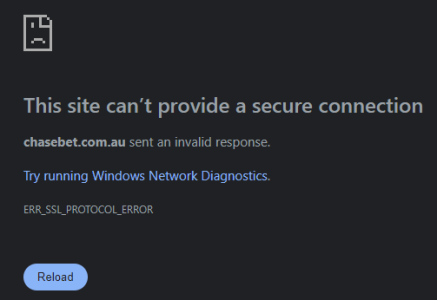

I've got an RT-AX56U and using it with the latest Asus Merlin (388.2_2) on a fibre internet connection using IPoE (DHCP WAN).
The fibre is connected to an NTD which provides an Ethernet connection to the WAN port on the Asus router.
I have nothing special or unusual configured and am using the ISP's DNS servers (have also tried using 1.1.1.1 and 8.8.8.8).
Whenever I visit https://chasebet.com.au in Firefox, I get this error:
In Chrome:
From a totally physical separate Linux PC connected via Ethernet:
$ lynx https://chasebet.com.au
From a Linux PC connected via WiFi using Chrome I get the exact same error as the Chrome Windows screenshot above.
As soon as I remove the Asus router from the equation and connect the Ethernet cable from the NTD directly into any of my PC's, I can access https://chasebet.com.au without any issues whatsoever.
I can also access it just fine from my mobile phone using 4G, but as soon as I turn on WiFi and the phone connects to the Asus, I get the same SSL issues.
It's not happening with any other sites, just this one in particular.

Does anyone have any suggestions on what the issue could be, or any further troubleshooting I could do to try and resolve this issue?

Only guess is aiprotection or parental controls are blocking that site, redirecting you to a page on the router, and the router has a self signed cert causing the browser to give you that warning.
Both AiProtection and Parental Controls are turned off, so it can't be that. I can access a whole bunch of other gambling related sites without any issue, it's just this particular Chasebet site that I can't access.

Only other thing I can think is maybe you had trend micro or parental enabled at some point and some of it is still active (didn't totally disable and something still lingering invisibly)? Have you gone to privacy and done "withdraw"? All else fails, maybe time for a hard reset. The only other intercept the router should be doing is if the WAN is down or if you go to the router page and have redirect to https enabled, but neither should be in play here.
Clicking 'Withdraw' from the Parental Control/AiProtection has resolved the issue.
Thank you so, so much. Saved me having to hard reset my router which I wasn't really looking forward to due to my custom DDNS setup etc.

Sorry I just assumed when you said it was disabled it was never enabled, should have mentioned the withdraw thing before. It doesn't seem to totally "let go" until you do that.
Try not to lose too much money 🙂
I must have enabled it at some point but didn't realise it wouldn't have 'let go' once I turned it off.
