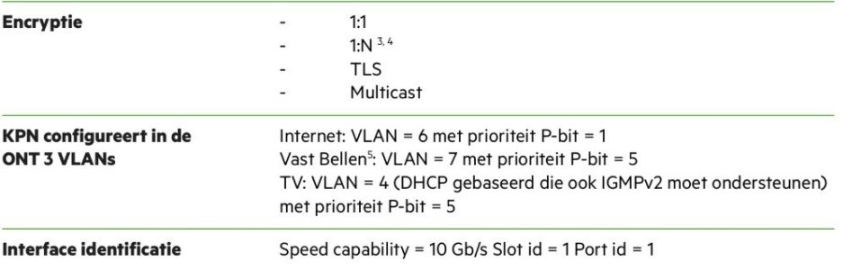

I've found the KPN document for using your own router which has the following spec for their internet protocol, it's in Dutch but I thinks it's understandable what they are needing settings wise?

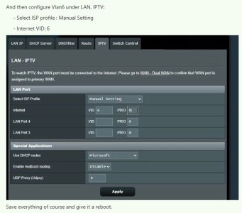

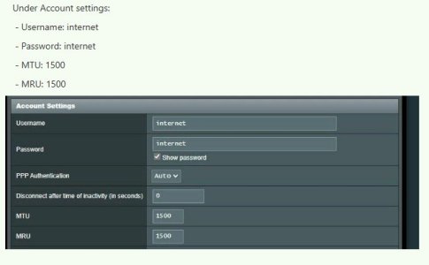

I have also found the following settings in the KPN forum that someone has suggested to use;
In the IPTV section there is also a drop down choice for KPN Netherlands, but this is surely too simple to be the solution? I would just plug the IPTV TV box into the ethernet LAN4 port?

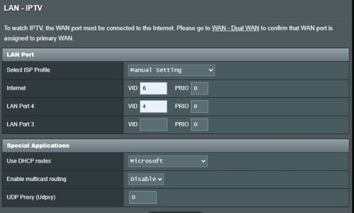

I have no plans to want to use WIFI for IPTV, as we will connect the TV box via a dedicated port on the router. The above settings however do not specify a specific port for the IPTV connection? My thinking was that I assign it to LAN4 by doing the following if I don't use the KPN (Netherlands) selection from the drop down menu?
I don't really understand how to add scripts etc, so i'd like to keep it as simple as just changing the information in the router selections if possible?
