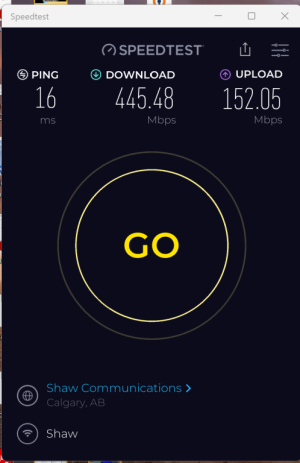

Thanks everyone! The 80Mz was the secret sauce! I don't know why but the Surface Pro 8 wants that setting. Works great on WiFi6 now as per the attached speed test. Thanks again. I just needed to be pushed in the right direction.👌👍

Actually this worked out even better than I expected. My internet plan is 500Mb and all wilfi6 devices are getting close to that. I know that if any of those connect to the ac68u they'll be limited but that would only happen if I were in my garage where the ac68u is located for minor devices there. I'm extremely happy with this. I never expected to get in excess of 450Mb on any wifi device. And the signal strength is great too. Thanks again to everyone.
