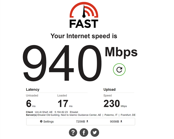

the only reason I wanted to get the RT-AX86U is that you keep saying your latency is lower. This is my latency now (using the best Monoprice LAN cables BTW if you remember I had asked you before for a suggestion, don't waste your money, the latency didn't improve with those cables)
I initially wanted to get the RT-AX86U based on your recommendation and low latency but that all changed with the announcement of the PRO model. Still not sure if it's worth the upgrade.

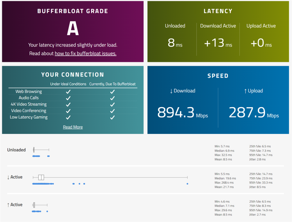

You need to manage bufferbloat with fq codel or cake.
Here's the test for it:
I get an A+. But I'm only running the AX86U as an AP. My APU2 is running fq codel.
here is my score

How is his speedtest / bufferbloat test reflective of "ridiculously bad" latency?
@Spartan just trusted someone changing the router will give him lower latency.
Nobody has stated that. Reading the entire thread is important.
@Spartan has an Asus home router. From what's available in Asuswrt (Merlin) the best setting for Gigabit ISP line is no QoS. Turning on Cake will cut WAN-LAN throughput to 1/3 and fq_codel is not available anymore (since 386 code base, if I remember correctly), except in custom script experiments. Adaptive QoS is struggling with Gigabit line and doesn't work very well in general. Again, custom script was an attempt to fix it. Traditional QoS and Bandwidth Limiter are also incompatible with NAT acceleration. When you give advice to someone make sure it applies to the situation and is possible on the hardware in question.
I misread his post. I was wrong. I'm not a fan of QoS other than latency mitigations with fq_codel, cake, and PIE. PIE now comes with DOCSIS 3.1 cable modems, so off the line, I see much lower latency. The worse latency I have experienced in the southeast with Comcast. High latency (50-100ms) off the line with a low 60/10 setup between 2014-2018.
If he's already getting A (<30ms) latency on the wire, then he can't do much without offloading to another device with very good CPUs (2+ GHz) and good nics based on other responses. And based on what's being said for Merlin, it's not worth using the ax86u to try to get it down a little less. I'm not sure it's worth the cost. Might be easier to run ethernet cable.
