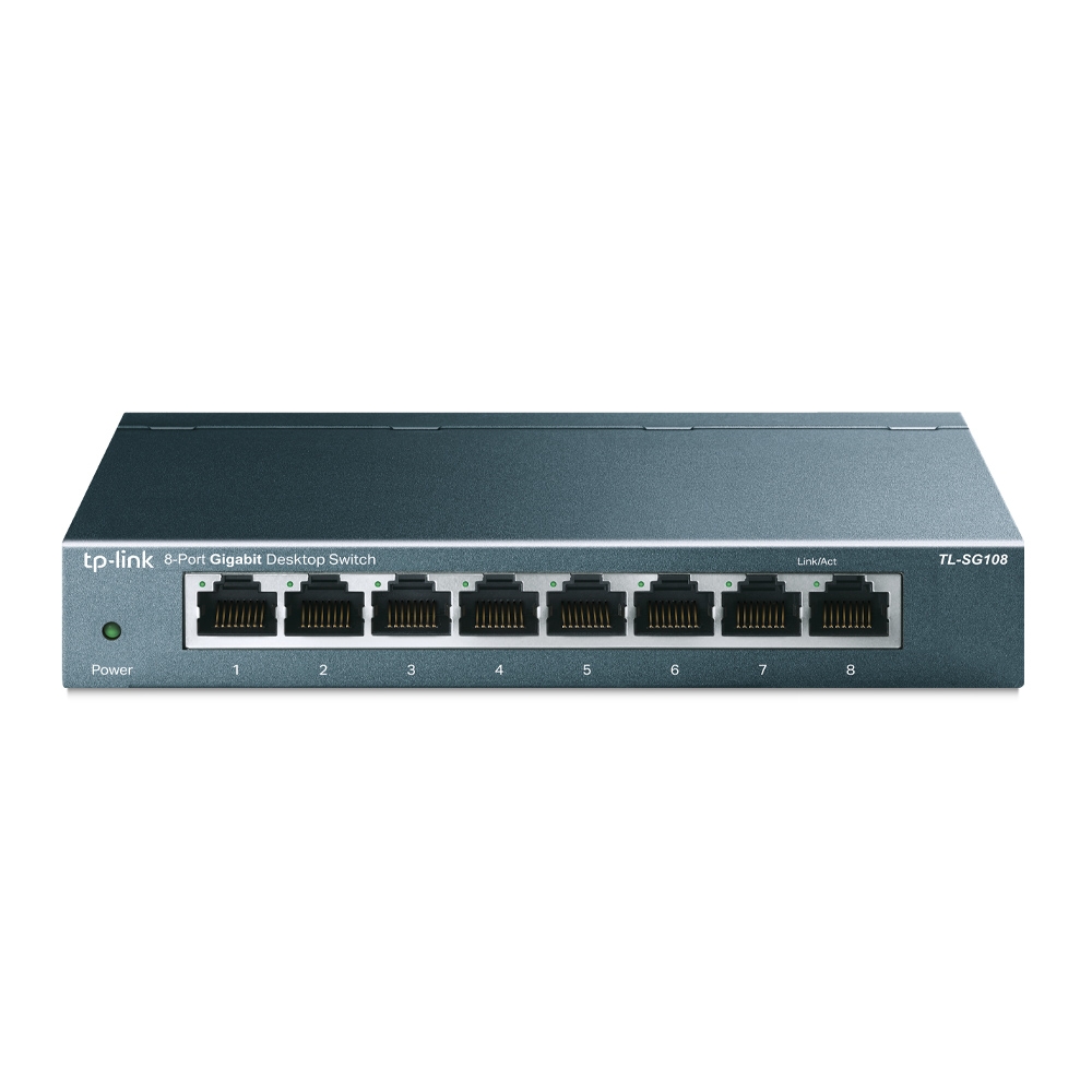

So found AX6000, but it has only 4 ports, so i need to get an extra Switch for more ports.

Agree with the above comments. Buy the GT-AX6000 today along with a $20 switch.

if i go with this option I need to add extra switch no sure yet which one
But then im not sure what advantage brings that 2.5Gbps port on GT-AX6000 router, as all ports on on switch are only 1000mbps

I would think you can find 1G switches used. 2.5G switches maybe not so much.
