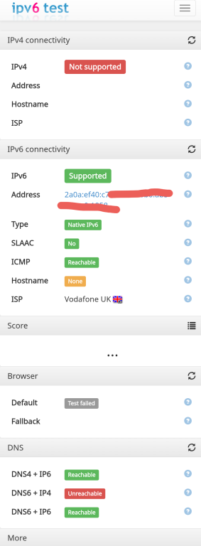

What does the score on this site say?
https://test-ipv6.com/
PS: I don't use IPv6 so I get a zero score.
Hope this helps.
