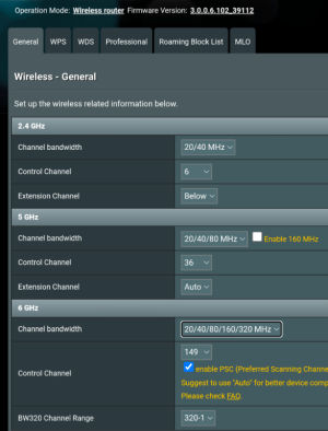

All wifi crashed... Took a look at the logs and kept seeing these several times per minute or even several times per second:
kernel: WLC_SCB_DEAUTHORIZE error (-30)
kernel: WLC_SCB_DEAUTHENTICATE_FOR_REASON err -30
Google search says "caused by a bug in the Wi-Fi driver related to advanced power-saving features, especially Multi-Link Operation (MLO) in Wi-Fi 7"
I have now turned off MLO, I guess we'll see what happens... Maybe I should just send it back... Ugh...
