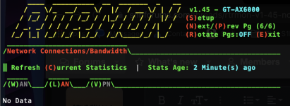

I installed the update this evening, but all I see is "No Data" on page 6.
Try hitting the "C" key to refresh your "C"urrent stats! Oh wait... Looks like you might have already tried that. Lol
Drop to a command prompt... Can you run the command "iftop"?
# iftop
-sh: iftop: not found
# iftop
That's what I feared. Ok, I'll send another release here shortly that will check for it and install it. In the interim, try running this:
opkg update
opkg install iftop
opkg update
opkg install iftop
Already did that, and it fixed it!
Thanks much to @visortgw for confirming that iftop is *not* part of the standard install, and requires a separate opkg install. RTRMON has now been updated to check for this, and will prompt for the tool to be installed.
