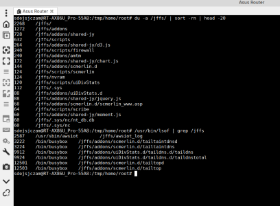

I’m not sure what’s going on but my JFFS is completely filled and causing my router to essentially crash. I can’t even look at logs in the routers GUI because it locks up my routers GUI.
I tried to delete the logs after I SSH into the router but still having problems. This is the second time this has happened to me in a two weeks.
I’m not even sure it’s scribe causing it but that’s what I think maybe the reason. Please correct me if I’m wrong.
Here are some screen shots. I really have no idea how to process except trying to delete the logs to get the JFFS down to a normal size so my router doesn’t freeze up.
See what’s taking up space:
du -a /jffs/ | sort -rn | head -20
/usr/bin/lsof | grep /jffs
My router was so unstable I deleted the logs and reclaimed the space. I have the feeling this will happen again soon though so I took note of the commands you listed and will use them if it happens again. I'll upload the output then. Thanks for responding.
Run it every now and then to see if something is slowly growing.
Here is the output of those commands, which I have no idea what they mean:
The first command is showing the sizes of the top 20 largest files/directories. See if it changes significantly tomorrow. The second command is showing which processes have open files on /jffs, just as a check of what might be writing regularly.
Note that Scribe (using syslog-ng and logrotate) does not write any logs to the JFFS partition; everything goes to the USB-attached drive; all log files specifically are written to the '/opt/var/log' directory. It appears to me that something else might be going on, which results in filling up the JFFS partition.
BTW, how large were the log files? And, were those logs located in the '/opt/var/log' directory as expected?
