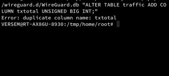

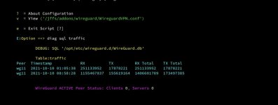

Well, attached the results I am getting. How do I go from here? Is that error effects anything or I can just ignore it?

Well, you could always follow my link above to issue the commands from the shell to add the columns in your existing database...
//Zeb
Tried your method. I get that. Thanks

Sorry, was to fast in my assumptions and didn't read your initial text. Looks like you have the correct columns. But wgm is not supplying all data.
Are you sure you are running latest dev version of wgm?
Starting over with a fresh database as @Martineau suggest is probably the best way.
The error will only affect statistic calculation and not the operation in general. Think you can leave it there.
