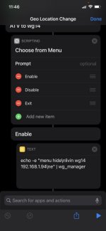

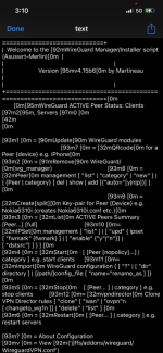

I did run it in one go. Still getting the menu
Yep, the initial menu still shows (but not a second time?)... as I see it you have two options in the posts above (for the time being)
1. Turn off Shortcuts ssh output according to @chongnt
2. Turn off menu compleatally in wgm config according to @Martineau

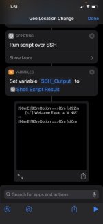

That works! thank you
@abir1909 / @ZebMcKayhan
I've pushed another wireguard_manager HOTFIX v4.15b6
To tidy up the Siri output, you can now permanently disable ALL ANSI/ASCII colour/attribute control sequences

and the SSH Button results should now appear a lot more readable on Siri
e.g. Before
[96mE:9mOption ==>[0m [s92m]
Welcome Expat to 'Paris'
[96mE:[93mOption --->[0m [s[0m
After
Option ==>
Option ===>

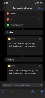

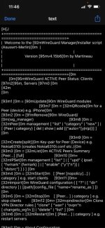

I tested it. Not sure what I am doing wrong.
I updated wgm. I ran color off. And still getting the long output.
The menu hide still gives you the initial menu and colour off only removes the escape characters Instead, try:
echo -e "colour off\nlivin wg12 192.168.1.94\ne" | wg_manager | awk '/Option ==>/{flag=1; next} /WireGuard ACTIVE/{flag=0} flag'
And:
echo -e "colour off\nlivin @home 192.168.1.94\ne" | wg_manager | awk '/Option ==>/{flag=1; next} /WireGuard ACTIVE/{flag=0} flag'
It should give a neat output.
And:
It did Thx

But as you say the technique works, and setting the desired command is more than likely a one-off.
passing the request string to SSH Button/Siri is slightly slower, longer to type but more reliable?
Thinking that if you are going to use wgmExpo you might aswell use it for all you want to do for easier command, instead of:
wg_manager colour off; wgm_manager menu off;
wg_manager stop wg11; wg_manager start wg13; wgm_manager show; wgmExpo "livin wg12 192.168.1.94"
Then:
wgmExpo "colour off\nstop wg11\nstart wg13\nshow\nlivin wg12 192.168.1.94"
Can't comment on efficiency or reliability though.
I'm not sure I would like to permanently turn off either menu or colors since I would probably be confused the next time I want to use it in ssh and have to look up the commands to enable it again.
By the way, what is the command to turn the menu back on? (I'm asking because this friend of mine accidently... ;))
menu show
or
menu on
