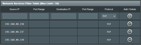

However, I am interested to know whether Firewall > Network Services Filter works?
As I am confused about whether the filter works for incoming traffic or outgoing traffic?
(I am confused about the Source IP & Destination IP)
Does the configuration below block all traffic in both ways? Incoming & Outgoing?
See below:
Thanks.
Appreciate someone can clarify.
No, the NSF does not block both ways. As stated in the description on that page: "The Network Services filter blocks the LAN to WAN packet exchanges...".
That said, usually it's sufficient to only block LAN to WAN traffic because if a LAN device can't send any traffic out to the internet it won't be getting a reply.
The main difference between "Block Internet Access " and the NSF is that the first works on MAC address and the latter works by IP address(s).
P.S. Don't use "TCP ALL" it doesn't do what you think it does. If you want to block TCP traffic select "TCP".
Can I confirm whether the setting is right? :rolleyes:
Block LAN to WAN, so it is outgoing traffic so....
Source IP = my network cameras
Port Range = 1:65535 --> correct?
Destination = Blank /Any (don't care)
Port Range = 1:65565 --> correct?
Protocol = TCP
Alright, thanks for the info. ;)
You don't need to explicitly specify the port range as the default is "all ports".
If you need to block UDP traffic as well you will have to create separate rules for that.
Because the NSF blocks by IP address you still need to bind your cameras' MAC addresses to their IP addresses to make sure they don't change. If their IP addresses change the NSF rule won't work. That's why using the "Block Internet Access" option may be better, because it's not reliant on the IP address.
