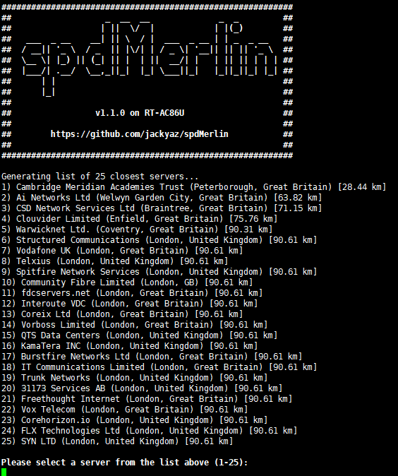

I assume its pulling location based off IP address? I ask because mine normally shows NC at work, but actually closer to Atl, GA server. Same for the house, have speedtest server like down the road but GA server shows as closest.
It's using --list from speedtest-cli - so I don't know how it queries your location
I never have pings of 80-90 (average 25-30) so
I am wondering what location it is going by....uhmmm.
my pings are up to 12 from 0 still get zero at speediest page.
everything else matches up.

dont know if it relevant but running "/jffs/scripts/spdcli.py --list "
gives me a list of servers none from Europe the closest being 8000km.
My real closest server is 1km away.
