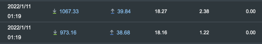

As another data point, I had the same experience with my RT-AX88U connected to Spectrum's 1Gbps down/35 Mbps up. Once I "upgraded" to an RT-AX86U as my primary router, I configured the router's 2.5Gbps port as its WAN port — the Spectrum-provided modem has a matching 2.5Mbps WAN port as well. My WAN speeds from both spdMerlin and the router's built-in speed test under the Adaptive QOS tab have increased by 200Mbps or so. FYI, I do not currently use adaptive QOS as I have not seen any benefit in my tests given my connection speeds.

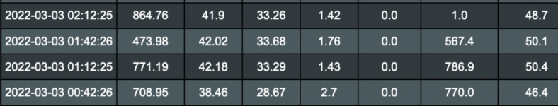

My AC86U over a FTTH non-PPPoE gigabit connection running 386.5 with Runner: Enabled - Flow Cache: Enabled just got the following.
Looking at the older values on pre-386.5 firmware my max speeds were around 600 Mbps.
Edit: Just to be clear, this is using the firmware GUI test and not the script.
