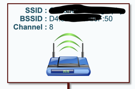

That's why I check every month what channel is less used. Here a screenshot of all wifi signals around me. As you can see channel 3 is used many times also
The 2 blue lines is my 2.4Ghz and below 5 Ghz.
In my GTAX11000 there is a Wifi channel statistics ( https://192.168.100.1:7443/channelcapacity.asp )
Now start a test to see everything
Here some results.
Seems channel 3 has more capacity then 8 and below. channel 3 has almost no non-wifi traffic interference and channel 8 much more on 40mhz.
So what you saying about let router choose is own channel can be an option. But ESP devices don't like channel 12, 13 and 14. So that was also the reason I did it manual.
But below tests shows me now that channel 3 is much better even there are more other routers using this channel.
