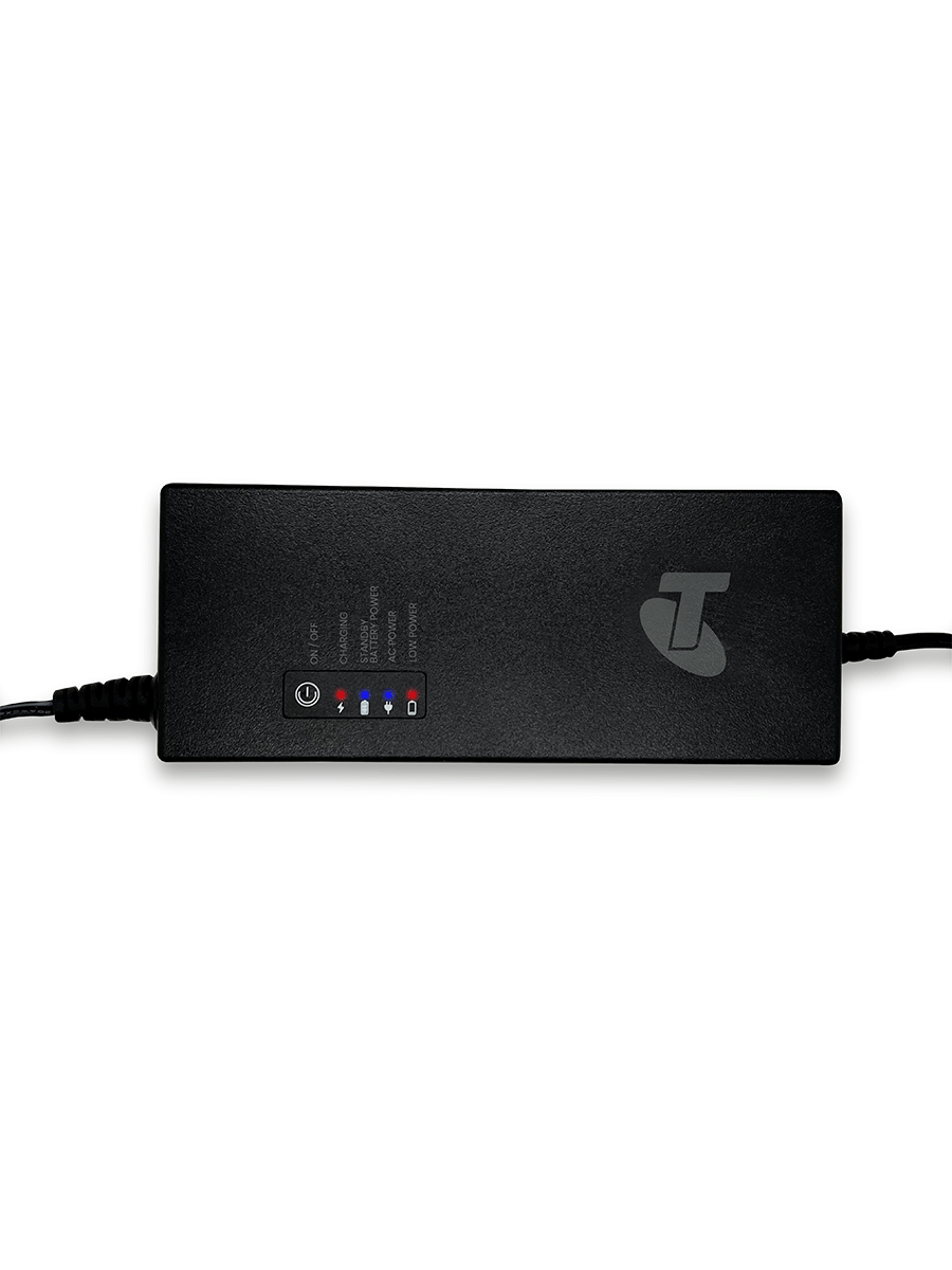

The RT-AC88U is what we are currently using but I think we'll go over to the Telstra Router (which will be better for an internet outage). Telstra also sell a lithium ups:
They don't say how long this will power their Telstra Gen 4 Smart Modem for (I couldn't imagine it would be very long). Also I wouldn't think this could be plugged into another ups. Would be easier to know which way to go, this ups battery or a 240v ups.
i would ask Telstra what they do for larger loading of the UPS for commercial customers. You may have to talk the the business contract reps instead of residential. You can place UPSs in series, but you will need to check if the stepped sine wave input to the second UPS will cause an issue. This has been a problem in the past.
