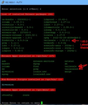

I recently checked for and updated amtm Entware packages, and was surprised to see tailscale amongst them, which duly updated (to 1.58.1, which is not quite the latest stable track 1.60.0 per https://pkgs.tailscale.com/stable/#static). Can I assume this tailscale update under amtm is actually because of my own implementation of it as discussed in this thread and not because amtm now has it built in?
In any case it seems to have stopped my tailscale implementation working, so I think I will need to go through the above procedure again. I rebooted the router but it did not connect to tailscale again.
@RandomUser777 - have you seen this issue when updating amtm Entware packages, if you have done that?
@thelonelycoder - I appreciate you do not (currently :)) support this install of Tailscale, but as amtm (appears to update it, albeit not the latest stable version), I thought I would ask if there is a way to exclude the tailscale update from the Entware packages update please and also stop it from modifying /opt/etc/init.d/S06tailscaled?
Thanks a lot !
k.
EDIT: it seems the amtm package update only reset /opt/etc/init.d/S06tailscaled, so I redid that file as above and rebooted and seem to have tailscale back with the latest version, which I grabbed from https://pkgs.tailscale.com/stable/#static and copied across.
I've faced the same problem with the sysstat package. I need to modify the S99sysstat script, but every time there's an update it gets overwritten. There's an option in opkg to prevent a package being updated (e.g. opkg flag hold sysstat), but that applies to the whole package rather than one file.
I ran `opkg flag hold tailscale` to protect the manual TailScale binary that's up to date.
Entware seems to update their repo very rarely.
That is useful thanks, but would I be I correct in assuming it wouldn't protect the S06tailscaled file?
As an aside, if I wanted to update that tailscale file (manually), what would be the command to briefly unprotect it so I can overwite it?
S06tailscaled part of the Entware package. So yes, putting a hold on the tailscale package will prevent that file and all the other files in the package being updated by opkg upgrade.
There's nothing to stop you manually editing that file with something like vi or nano.

Be careful if you do this. Adding .bak at the end of a filename doesn't confer any special meaning. All you've done is create a second startup script. Any user executable script whose filename begins with "S" found in init.d will be run at startup. So you either need to move this backup file to a different directory, or change its name and/or permissions.

This won't work in this case. opkg is being run by the root user which has no problem overwriting a file with the "correct" version, including changing its permissions back again.

Be careful if you do this. Adding .bak at the end of a filename doesn't infer any special meaning. All you've done is create a second startup script. Any user executable script whose filename begins with "S" found in init.d will be run at startup. So you either need to move this backup file to a different directory, or change its name and/or permissions.
Looking at the script that parses the init.d directory, any file that does not have the execute attribute set is skipped.
Personally, I don't keep backup files in the same directory to avoid confusion, but as long as the backup file is not executable,it should be ignored.

Yes, that's why I specifically said "Any user executable script whose filename begins with S", meaning the execute bit being set for the user permissions. On my router the default umask is such that if I simply copy the file the new file will have this permission set.
