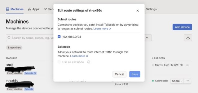

Hi

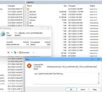

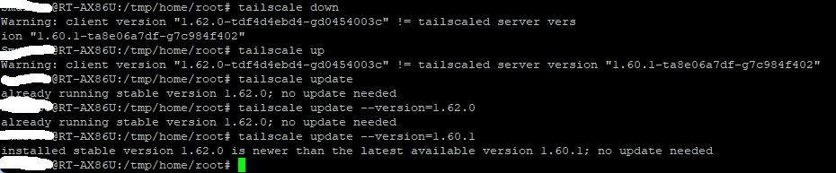

Coming to you @RandomUser777 (or anyone else) for a bit of help because I think I stuffed up my install trying to update it this way (above) rather than issung "tailscale update" from the CLI.
Copying the two files, one (tailscale) copies and the other (tailscaled) throws an error about a text file being busy.
I tried "tailscale down" from the CLI (no go) and I tried to revert to the previous version (no go) and I tried rebooting the router (no go).
Before I redo the whole thing, is there a simple way to get the updated "tailscaled" file to copy across (preferably in WinSCP) please?

[EDIT1]
I think I found a way to do it, I went into the S06tailscaled file located in:
/opt/etc/init.d/
and commented out these two lines:
#PROCS=tailscaled
#ARGS="-tun=userspace-networking -statedir /mnt/DIVEXT4/tailscale/"
I then saved the file, rebooted the router, copied the tailscaled file across to (successfully) overwrite the previously "busy" file.
I then re-edited S06tailscaled file to remove the commented out # prefix.
Rebooted the router again, checked the tailscale status and version with "tailscale status" and "tailscale version" and it appears all is well.

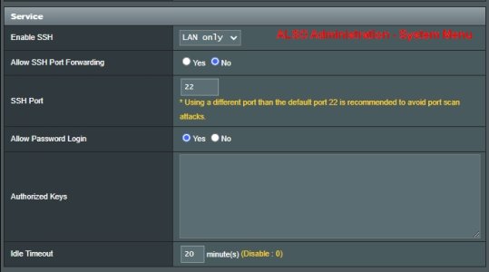

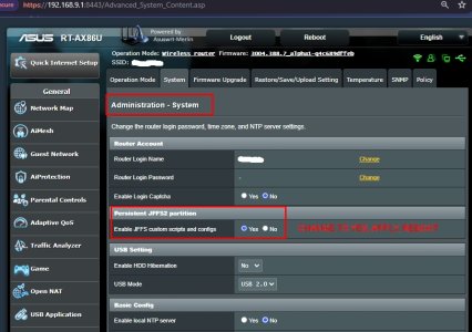

1. Ensure jffs Custom Scripts is ENABLED in your Admin-System menu (see pic below); and
2. Ensure SSH is ENABLED in your Admin-System menu; reboot.
3. Test SSH Access is succesful using Putty and WinSCP; get this right first, you cannot do anything without it. Access your Router's admin IP Address, same as the GUI address, you can run it with the GUI open too. Check in the mnt shortcut what the name of your disk is as you will need it in the 'ARGS' line below (note that you will only see this AFTER you attach and format a drive).

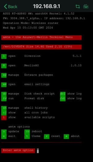

4a. Run amtm from CLI (ssh in to your Router using Putty) and just type amtm. Starting with Asuswrt-Merlin 384.15, amtm is included in the firmware; then
4b. Install entware from the amtm menu (a prerequisite).
4c. Then Install the Format Disk Script from within amtm, it’s called "fd" (unless you just want to use the CLI for formatting the disk). See amtm menu pic below for what it looks like when it is installed. Note I have a couple of other scripts showing in that pic (Diversion, MerlinAU), that you do not need for this install.

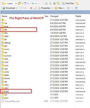

8. Fire up WinSCP (slr to Putty but like a Windows Explorer Version, easy to navigate to dirs).
Once into your Router using WinSCP (normally the right pane), navigate back up the directory tree to the very root dir, then go back down and navigate to /opt/bin/. Copy the two Tailscale files you previously saved onto your Windows Desktop DIR and overwrite the ones already in in /opt/bin/.

How are you trying to “connect” to it using Tailscale? Remotely? To test it you should be able to turn on Tailscale (eg from your phone as an App, but just on LTE or 5G or a 3rd party Wi-Fi, not on your own Wi-Fi ), then type the Router IP in your phone browser as if you were inside your network and access the Router via the Webgui.
If you want to set it up as a subnet Router (not sure it needs to be) then you need to do that from the Tailscale admin (see screenshot).
Click the dots then select Edit Route Settings, then select subnet routes and the route IP itself.
The only other thing I can think of is your Routes in the two scripts are not the same as your own subnet?
So near, yet so far. I would be very grateful if you could please check whether the contents of your "firewall-start" and "services-start" files are the same as mine. I have tried adding the additional first lines (and your prior comments) as per screenshots as well but no joy:
I have tried to remotely connect to the router via tailscale using my Pixel 7 (using LTE rather than same WiFi network) as shown below but has been unable to do so. Also router is not routing tailscale to its subnet (no such option in tailscale admin panel as you can probably see -unlike my GL-MT6000-):
Based on a check of my own scripts in jffs/scripts, yours both appear correct for your subnet 192.168.1.0 (WebGui 192.168.1.1).
Hmmm.. looking at Tailscale docs, "--advertise-routes=192.168.1.0/24" should do this; and it's already in your scripts. You rebooted after the script was amended right?
Hmm.. seems not to acknowledge the advertised Routes. I will need to do a bit of thinking about why not (and hope some person cleverer than I comes along in the interim :) ).
