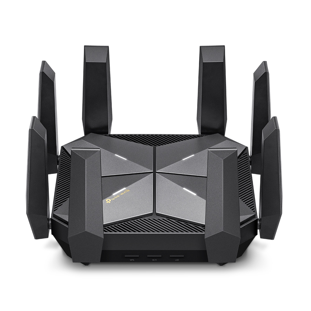

No, the AXE300 i have does not have motorized antennas. Not sure if TP Link decided against having motorized antennas or will use them on a different AXE model. This is the model i have:

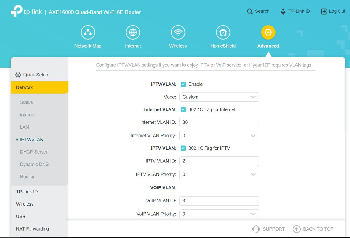

If you're having issues with the upload, have you tried playing with the VLAN settings, assuming your ISP uses a VLAN setting? In my case, Etisalat uses VLAN=30 and these are the settings I have on the router (btw i'm not using IPTV or VOIP, these are just random values I entered)
