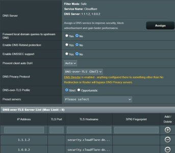

The default setting on my new ASUS RT-AX88U Pro was "auto" and I haven't changed it so far as I don't know what the difference is. I do remember that I did try using "yes" on my previous router and I found I had some problems (I can't remember the details but I think I had trouble accessing some web sites), so I won't be using that option again. So my only consideration is whether to use "no" as per your suggestion or leave it on auto. Can you explain the difference for me (in simple terms) so that I can make an informed choice?
In my Asus RT-AX88U with newly loaded Merlin 388.2 firmware, the default setting of "Prevent client auto DoH" is also "Auto" :) Maybe I will change to "No" after DNS check tools confirming of no DNS leakage.
We have some misunderstanding here. This:
Located above DoH setting. Perhaps "the three settings above" is more clear. DoH is Auto by default, but doesn't work for many clients. I believe it's Firefox browser specific when they switched to DoH. Apple devices do DoH via iCloud Private Relay regardless if the service is not blocked.

Read carefully again:
Now it's clear what caused the confusion, the word "above" being left in limbo and the focus only on the description of the option "Prevent auto client DoH" in ON/OFF/AUTO. :D

Now back to the topic, I turned off both options:
Enable DNSSEC support = No
Validate unsigned DNSSEC replies = No
Tested on 3 different sites, as a result they got DNSSEC supported :rolleyes:.

My settings:
You can leave Rebind protection to default No as well. The upstream servers won't resolve non-routable addresses anyway.
Since I have this option enable, alerts have been appearing in the log like this:
dnsmasq[2526]: possible DNS-rebind attack detected:
Now I don't know if it's a false alarm or simply because the option is active, referring to what you mentioned above...
False alarm because of option enabled.
