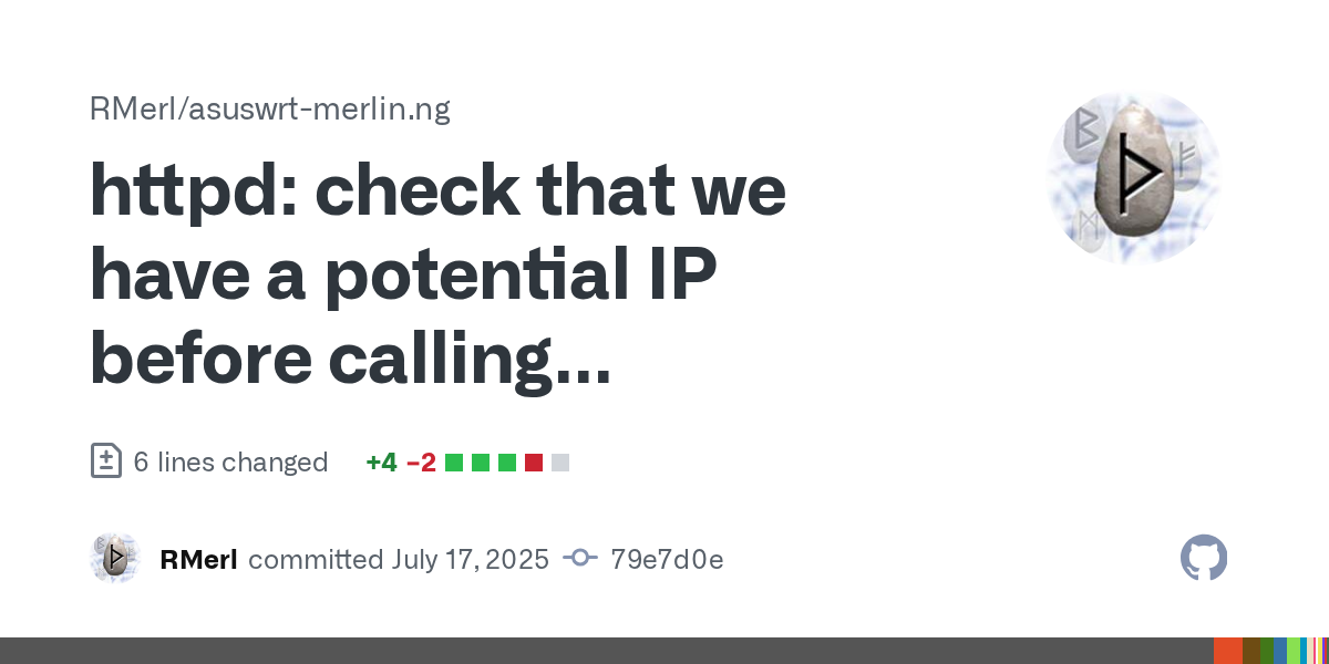

The router calls ParseIPv4OrIPv6() on your hostname, and it fails to detect "bifrost" as being a hostname and considers it to be an IP.
The simplest workaround on your end is within your local host file, add a FQDN for it. I.e.:
192.168.50.1 bifrost bifrost.mylonely.lan
Then if you use https://byfrost.mylonely.lan:8443 it will properly be detected as a hostname, and get correctly parsed.
I can probably protect ParseIPv4OrIPv6() by checking first if the string is devoid of any dot and bracket (an IPv6 would be enclosed in brackets), in which case I would process it as a hostname. That wouldn't be 100% fool proof, but a proper fix would probably require the lengthy ParseIPv4OrIPv6() function to be reworked - not something I'm really keen on attacking myself.

It probably also does it this way so it can validate the certificate before reloading it.
This should take care of most cases of incorrectly detected IPs.
I had a look at potentially rewriting ParseIPv4OrIPv6(), but too many chances of something else breaking along the way.
