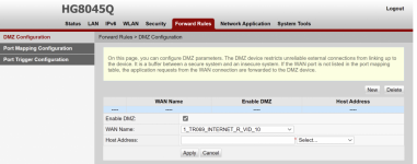

I am not that familiar with DMZ. I can see that I can add IP addresses to the Huawei DMZ configuration. I should add the Asus WAN IP address to the Huawei DMZ configuration?
P.S. I assumed that configuring DMZ would involve designating one LAN as a DMZ network. Not that I can see such a configuration.

Your Asus router has a reserved IP address on Huawei router. Put this address in DMZ host field, Apply, reboot the Huawei router. DMZ exposes the host to Internet, saving you port forwarding on two routers. It's often used as workaround when the ISP equipment doesn't have bridge mode.
Thanks for the suggestions. I have set up the WAN address of the ASUS router in the DMZ host field of the Huawei router and rebooted the Huawei router. Unfortunately, it did not resolve the issue. Both the Fingbox and Ring still are reporting disconnections.
