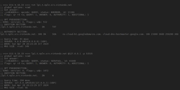

Here is when using dig
A:Option ==> dig lp1.t.npln.srv.nintendo.net
; <<>> DiG 9.18.19 <<>> txt lp1.t.npln.srv.nintendo.net
;; global options: +cmd
;; Got answer:
;; ->>HEADER<<- opcode: QUERY, status: NOERROR, id: 21189
;; flags: qr rd ra; QUERY: 1, ANSWER: 0, AUTHORITY: 1, ADDITIONAL: 1
;; OPT PSEUDOSECTION:
; EDNS: version: 0, flags:; udp: 512
;; QUESTION SECTION:
;lp1.t.npln.srv.nintendo.net.   IN      TXT
;; AUTHORITY SECTION:
lp1.t.npln.srv.nintendo.net. 300 IN     SOA     ns-cloud-b1.googledomains.com. cloud-dns-hostmaster.google.com. 186 21600 3600 259200 300
;; Query time: 41 msec
;; SERVER: 8.8.8.8#53(8.8.8.8) (UDP)
;; WHEN: Sun Apr 28 20:23:28 ICT 2024
;; MSG SIZE  rcvd: 149
; <<>> DiG 9.18.19 <<>> lp1.t.npln.srv.nintendo.net @127.0.0.1 -p 53535
;; Got answer:
;; ->>HEADER<<- opcode: QUERY, status: SERVFAIL, id: 41648
;; flags: qr rd ra; QUERY: 1, ANSWER: 0, AUTHORITY: 0, ADDITIONAL: 1
; EDNS: version: 0, flags:; udp: 1472
;lp1.t.npln.srv.nintendo.net.   IN      A
;; Query time: 294 msec
;; SERVER: 127.0.0.1#53535(127.0.0.1) (UDP)
;; WHEN: Sun Apr 28 20:23:29 ICT 2024
;; MSG SIZE  rcvd: 56

I think you are mis-reading the response from your router.
The 1st nslookup is *not* returning a value !!!???
When you run a nslookup command you should get a response that is the IP address(es) matching the 'Name' queried.
[See line starting Address 1: ---> shows IPV4 address]
Your nslookup command is simply returning the queried name .... no IP Address is being resolved.
This is the same response that 'unbound' is returning ... there is no IP Addresss matching that name, hence the 'can't find' message.
Thank you for your explains.
I'm honestly don't know how that address works.
After checking the log only thing I know is the SERVFAIL message appeared when I failed to connect to the internet in game. And can only connect when I turned off Unbound.
The difference is that Unbound is returning an NXDOMAIN error, whereas other DNS servers are returning a SOA record. Neither of them are retuning an IP address but I don't think it's meant to. I don't know what the Nintendo device is using the SOA record for.
After reading the following ---> What is a DNS SOA record ?
[P.S. cloudflare 'What is DNS' is a useful simple resource to understand DNS quickly :) ]
It would appear that the SOA record is being used to lookup the Primary nameserver for the zone. [ns-cloud-b1.googledomains.com]
This nameserver does not respond to port 53 calls, so I am guessing the nintendo device is using 'some other port number' to secure DNS use.
Unbound is 'getting in the way' of whatever the nintendo device does !!!!!
No simple solution !!!
