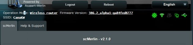

RT-AX88U on Merlin's 386.2_alpha1. No statistics in the GUI panels of Unbound even though I have the GUI option (#6) enabled Only data on display is in the written text section of the GUI. Unbound via AMTM, statistics there via the panel option #4. Have attempted...
1. Power off/on of AX88U. No Change.
2. Uninstalled and Reinstalled the GUI statistics (via option #6). Before I uninstall and re-install Unbound to see if that corrects, to debug want any data captured?

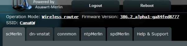

Lost the Unbound tab on the Addon tab. had about seven tabs in the Addon tab slection now only two. Powered Router Off/On but no change, only these two tabs now...as per pic.
Question: What's a process to recover the missing tabs for connmon, ntpmerlin, unbound etc to the addon tab?

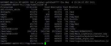

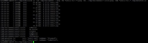

Can you list the output of
df
ls -lah /tmp/var/wwwext | grep -TE "user[1-9]+.*";grep -TH . /tmp/var/wwwext/*.title;grep -THE "user[1-9]\." /tmp/menuTree.js

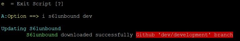

For unbound you can try
e  = Exit Script [?]
A:Option ==> i s61unbound dev
Updating S61unbound
    S61unbound downloaded successfully Github 'dev/development' branch
then reboot.
df
e  = Exit Script [?]
Updating S61unbound
then reboot.
Thanks Martineau! Here's the output...
Did the recovery step, reboot the router. Ironically the only tab on the AddOns tab not restored was "Unbound", all others were restored. :-)
Did the recovery step, reboot the router. Ironically the only tab on the AddOns tab not restored was "Unbound", all others were restored. :)
So you can see in PIC11.jpg there are two mount points for menutree.js ...so a new modified version of /tmp/menutree.js with a new Addon can never be created until one is manually removed.
You can see only two entries 'Flexqos' an 'scmerlin' were physically inserted into /tmp/menutree.js, although the .asp files for other tabs were created.
OK, so if you issue
umount  /www/require/modules/menuTree.js
df
then re-request the creation of the unbound Addon GUI using sgui does the tab immediately appear?
