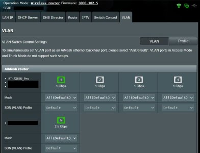

If the router supports Guest Network Pro/VLAN, then the VLAN tab in the LAN section will be (or should be) enabled. You may have to actually create a Guest Network Pro Profile first though in order to assign LAN ports to the VLAN.
Example VLAN tab from a RT-AX86U Pro running 3006.102.5 attached.
