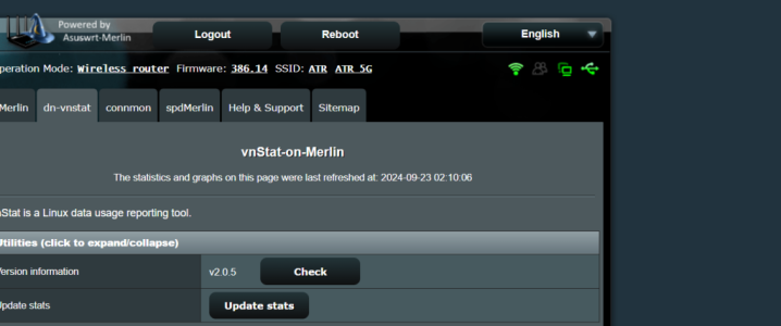

I already know that @Jack Yaz already updated his scripts for the missing vertical scrollbar (bug) which was newly introduced with Merlin 386.14 firmware for AC models. And I'm looking forward him merging these fixes in the master branches of his respective scripts and the same for other developers.
But weird enough for me, I didn't find anyone reporting on this forum the same (bug) with vnStat script, which is developed by @dev_null

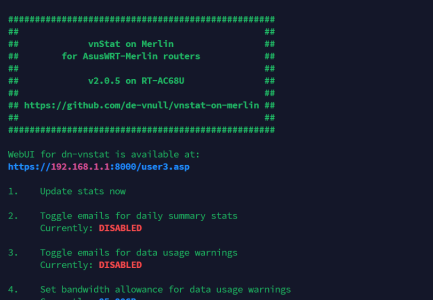

I have RT-AC68U running official Asuswrt Merlin 386.14, and vnStat version 2.0.5
Please note that I tested both master and develop branches, and both have the exact same issue. Any update on this issue would be very much appreciated!

I've submitted a pull request to @dev_null's GitHub repository to address the "missing scrollbar" issue when the webGUI page is loaded on the 386.14 F/W version.
Here's a screenshot showing the fix:
FYI.
This is great @Martinski, and thanks for submitting pull requests to all the scripts. I really highly appreciate your work.

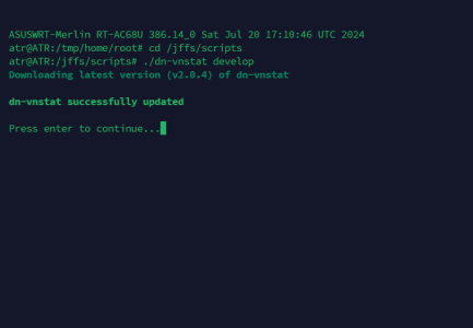

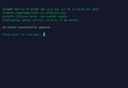

So, I guess I'll have to report another bug which is preventing me from reaching version 2.0.6, the one you fixed the bug at!
I'm unable to get version 2.0.6 through normal update methods, in both stable and develop branches!!!
Please check the attached screenshots ordered by time already. And advice me what to do or how to solve the issue.

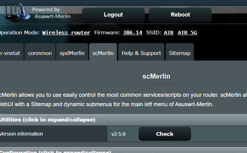

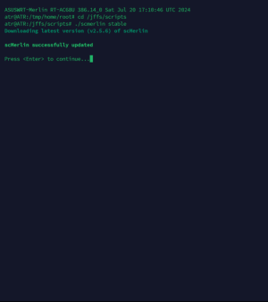

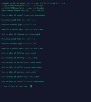

Additionally, and strangely enough, I have a somewhat similar problem with scMerlin script. When updating to the latest stable version it downloads the correct current version (2.5.6). But, when updating to the latest develop version, it doesn't recognize the version number, showing () in the terminal and N/A on the webpage!! Screenshots attached.
Although, after each update (stable and develop), the script still shows the correct version number (2.5.6) in the script's main menu in terminal only.
Moreover, the vertical scrollbar is available with both branches at the script's main web page, but not at the sitemap page!!

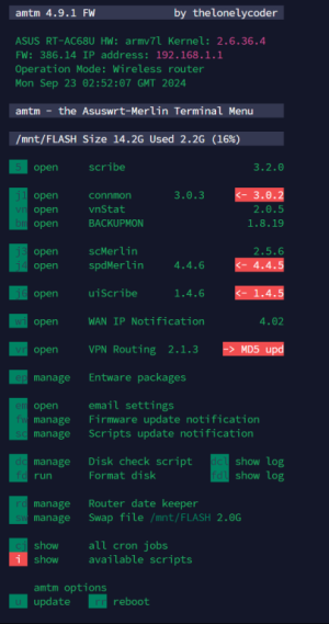

FYI, I have the latest versions of everything installed on my router. Here's a screenshot from my AMTM script.
Side note: MD5 difference for VPN Routing script is because I edited the script file only, as it can't get installed on my router using the original script file. That's because it checks for OpenVPN clients 3, 4, and 5 which are not present in RT-AC68U, and when it does that, the script never finishes! @Ranger802004
The fix in short is that I delete all lines related to the missing OpenVPN clients, where the script gets all system parameters. The first line for OVPNC3 is at line #4564 down till the last line for OVPNC5.
Starting line number is specific for the latest version of the script (2.1.3), as I used no other version that this.
The PR has *not* yet been merged. You need to wait for @dev_null to review and merge the code into his "official" repository, and only then the new 2.0.6 version would be available to everyone.
The issues WRT making update requests from the 'develop' branch & the missing scrollbar on the "Sitemap" webpage have been addressed on the latest scMerlin 2.5.7 version:
This makes sense now, so 2.0.6 is not available yet in both stable and develop branches. I misunderstood how the pull request works, now it's clear.
Let's hope @dev_null would be available soon to merge the fix. Thank you!
Thank you again for addressing these two issues in scMerlin, I just updated it and the missing scrollbar on the Sitemap page got fixed indeed.

Since this is taking too long, and it's unclear when a release would possibly be available, and as I somehow rely on this script. I wanted to make a temporary update to my installation on my router, so I went to the repo at GitHub, then to the Pull Request by @Martinski, and copied the content of vnstat-ui.asp and dn-vnstat.sh to their respective files in my router to get the script updated, and it fixed the missing scrollbar issue successfully.
However, I can't figure out which file to copy the content of vnstat-ui.js to in my router's script installation, as I've got no such file, or a file with a similar name here. Any help would be much appreciated.
I have accepted the changes provided by @Martinski for vnStat on Merlin. Note: I have no device running .14 so I can't test the scrollbar fix.
Apologies but I have been on travel. I will also add a comment to the main thread.
Many thanks to @Martinski
Many thanks to you @dev_null and @Martinski for the updates, and I'm sorry for being a little demanding 😊
I just force updated dn-vnstat and tested it right away. Scrollbar issue is officially fixed!
Best Regards
... and copied the content of vnstat-ui.asp and dn-vnstat.sh to their respective files in my router to get the script updated, and it fixed the missing scrollbar issue successfully.
However, I can't figure out which file to copy the content of vnstat-ui.js to in my router's script installation, as I've got no such file, or a file with a similar name here...
To address your concern and for future reference, the JavaScript code is embedded in the ASP file so for new version update purposes, you need to replace only 2 files: the shell script (dn-vnstat.sh) and the ASP (vnstat-ui.asp).
