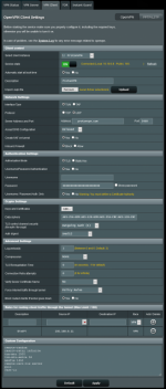

Here's a screenshot for the VPN client:
Screenshot_2021-04-11 ASUS Wireless Router RT-AC86U - OpenVPN Client Settings.png
But, is there a workaround to access my server, and still have its internet traffic forced through the VPN?
Let me rephrase that:
Is it possible for the router to reply to connected VPN clients (10.8.0.X) that 192.168.0.11 = 192.168.0.11, despite the fact that 192.168.0.11 is connected to a third-party VPN server with policy rules enabled on the router?
  • Screenshot_2021-04-11 ASUS Wireless Router RT-AC86U - OpenVPN Client Settings.png
Ahh now it's more clear.
Actually VPN clients should already send packets for 192.168.0.11 toward the router (which should route them correctly - you say that other devices are responding). I suppose the issue is on the routing tables that are pushing back the packets from 192.168.0.11 toward the subnet 10.8.0.0/24.
I'm afraid that the issue is in the limited configuration allowed by the interface: there you can only say forward all non local traffic to VPN, which includes also traffic toward 10.8.0.0/24 (that is not local network).
If this is the case, it gets tricky since it's not possible to specify that kind of configuration from the UI and it seems that adding the Force Internet traffic through tunnel doesn't take into account other networks (e.g.: the "ontheroad" VPN net).
This is not a simple network setup ;)
What comes to my mind is to avoid using the Force Internet traffic through tunnel option and to setup the firewall on the router to perform the required routing... however it's not possible to do that in a simple way from the UI...
You could try to skip direct VPN "Force Internet traffic" and to use x3mRouting (see documentation) which should allow to define selective routing by client.

Damn.
I did it. It was as simple as selecting "disabled" with "Accept DNS configuration" on VPN client :oops:
Everything is working fine. I'll have to run some more tests, but I think it's solved.
