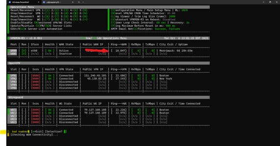

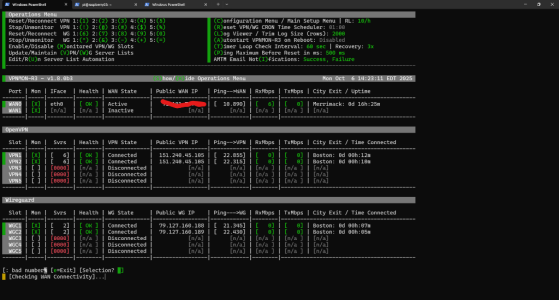

While getting things set-up after a router replacement I am seeing a [: bad number% ] next to the timer loop display when it
times out. I am also not seeing any rx/tx on the vpn slots. Should be seeing something on vpn1 slot for sure . Nothing is running thru the WG
slots yet.
slots yet.
That's definitely odd. Does it show any kind of 60 second counter? Can you show a copy of your .cfg file entries?
If the timer loop isn't even working, then you probably won't see any bandwidth stats. I need to take a look at my code to see if there's a requirement for a slot to be "monitored" before it shows these stats, or not. I will check this evening.
