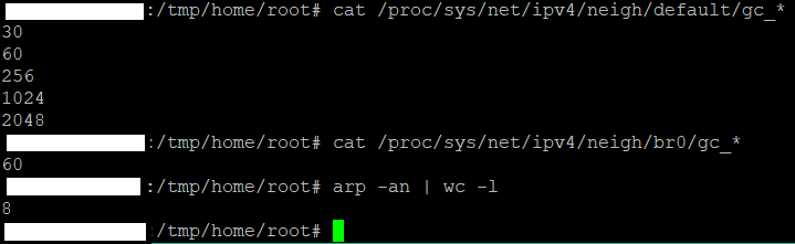

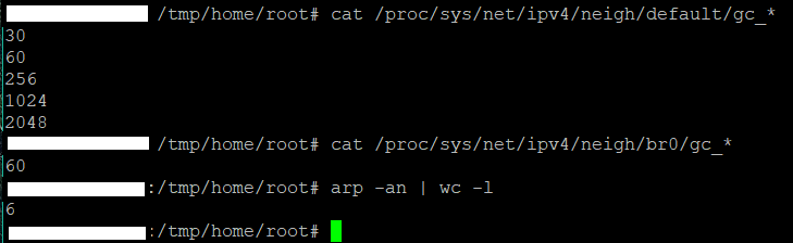

First, I entered these commands on the mobile phone, and the third command returned 7. And then on the PC, the third command returned 8.
After returning to 388.2alpha1, these commands return the same values as on the 388.2 release, except for the third one, which now returns 6.
