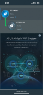

That's weird, I just created the Aimesh system last night,
right now it is running fine for almost 12 hours.
Although the channel I am using right now is seems to be a bit congestion,
Thats why I am looking to switch to DFS channel.

already got the answer,
the node will stays at previous working normal channel,
in stead of following the main router to channel 100.

I dont think it is the case. In order to form a working mesh network,
main router and mesh node should be on the same channel.
But whatever, I gave up on using DFS channel.
my router found radar signal right after a few minutes I switched to DFS. :rolleyes:
Should be a nearby weather radar.
