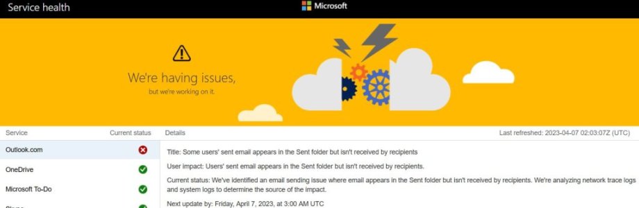

And a troubleshooting tidbit, whenever you have sending errors or aren't receiving sent messages always just check your sending server status..... Im about to get 40 Emails when they come back up

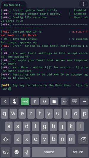

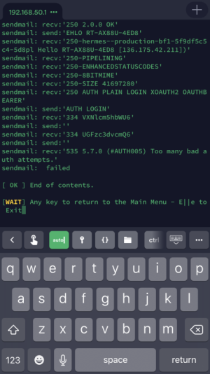

Hi everyone I got an issue it’s not sending a test email how do I fix?

Guessing the 535 is indicating your credentials are incorrect.
Ensure in Email edit menu (Main Menu 1), options 5 & 6 are the same Email login/from address and use option P in the main menu to re-enter your Email password.
You can also try configuring amtm Email and testing with it and if it works there use the import option
If you're using something like GMail you MUST enable 2 Factor Authentication and create a specific password for this script, or if the option exists with your Email provider enable 'Less Secure App' access
I’m using aol.com
Says it’s bad auth, login denied however I’m entering the right credentials
