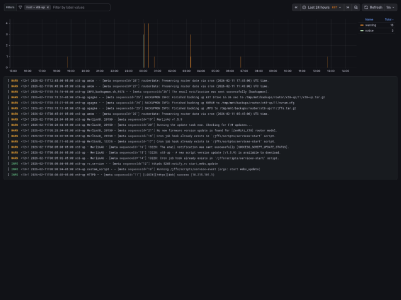

This is just a minor nuisance in MerlinAU logging. Just an FYI this is not new.
It has been this way for quite some time.
Some of the logging is normal for program name but some log entries are written with a NULL program name.
warn<12>1 2026-02-11T00:20:04-05:00 xt8-up MerlinAU_ 20150 - [meta sequenceId="19"] MerlinAU v1.5.9
warn<12>1 2026-02-11T00:20:04-05:00 xt8-up MerlinAU_ 20150 - [meta sequenceId="20"] Running the update task now. Checking for F/W updates...
warn<12>1 2026-02-11T00:20:04-05:00 xt8-up MerlinAU_ 20150 - [meta sequenceId="21"] No new firmware version update is found for [ZenWiFi_XT8] router model.
warn<12>1 2026-02-11T00:20:02-05:00 xt8-up MerlinAU_ 20150 - [meta sequenceId="18"] Cron job hook already exists in '/jffs/scripts/services-start' script.
warn<12>1 2026-02-11T00:05:11-05:00 xt8-up MerlinAU_ 13228 - [meta sequenceId="17"] Cron job hook already exists in '/jffs/scripts/services-start' script.
This is what I get when program name is NULL and I have to use a rewrite rule in syslog-ng conf.
rewrite null_pgrm { subst("^$","-", value(PROGRAM), flags()); };
warn<12>1 2026-02-11T00:05:08-05:00 xt8-up - MerlinAU - [meta sequenceId="16"] 13228: The email notification was sent successfully [SUCCESS_SCRIPT_UPDATE_STATUS].
warn<12>1 2026-02-11T00:05:04-05:00 xt8-up - MerlinAU - [meta sequenceId="15"] 13228: xt8-up - A new script version update (v1.5.9) is available to download.
warn<12>1 2026-02-11T00:05:02-05:00 xt8-up - MerlinAU - [meta sequenceId="14"] 13228: Cron job hook already exists in '/jffs/scripts/services-start' script.
This is from the messages file using a slight twist to the rewrite rule just to make it stand-out.
rewrite null_pgrm { subst("^$","MerlinAU", value(PROGRAM), flags()); };
2026-02-08T00:05:02.000000-05:00 xt8-up MerlinAU[MerlinAU]: 1003: Cron job hook already exists in '/jffs/scripts/services-start' script.
2026-02-08T00:20:02.000000-05:00 xt8-up MerlinAU[MerlinAU]: 6698: Cron job hook already exists in '/jffs/scripts/services-start' script.
This is from the messages file without any rewrite rule.
2026-02-11T00:05:02.000000-05:00 xt8-up [MerlinAU] 13228: Cron job hook already exists in '/jffs/scripts/services-start' script.
2026-02-11T00:05:04.000000-05:00 xt8-up [MerlinAU] 13228: xt8-up - A new script version update (v1.5.9) is available to download.
2026-02-11T00:05:08.000000-05:00 xt8-up [MerlinAU] 13228: The email notification was sent successfully [SUCCESS_SCRIPT_UPDATE_STATUS].

The above log entries were generated by the previously installed MerlinAU script (i.e. *before* the 1.5.9 version update). You will likely need to review and rework your syslog-ng configuration settings when filtering the slightly modified log entries starting from MerlinAU 1.5.9 version; then retest and verify using only those log messages.
I don't understand what you're saying in the above statement. The "program name" is meant to identify the name of the service or process that generates and sends the log entry, and based on all the log messages shown in your post, each one has "MerlinAU" as part of the message header, so how can it be NULL??
Can you elaborate and clarify what you mean exactly by "... some log entries are written with a NULL program name."?
Firstly I was very reluctant to post this as the intended recipients of a fix is way too small.
Also looking at the messages file it appears that everything is fine.
But I don't think adding a rewrite rule would apply a change to the message if it did not find something
that matched.
I am attaching my config files to see if you think something I am doing is in error.
This is a older log entry but nothing has changed thru any updates since first adding MerlinAU about a year ago.
The rewrite finds that the program/process/service name is NULL and replaces it with a value. Not sure why the pid field
contains the program/service name after the rewrite.
This ia an entry as is shows up in my loki syslog server using my current rewrite of replace NULL with a "-".
This oddity is not restricted to only MerlinAU as I had to appy rewrite rules that replace NULL values for other services.
I don't recall what services I had to add the first two for over a year ago when I first started sending logs to loki.
rewrite null_pid { subst("^$","-", value(PID), flags()); };
rewrite null_msgid { subst("^$","-", value(MSGID), flags()); };
I am perfectly fine with not pursuing this further since I believe the rewrite handles it adequately.
that matched.
Given all your results with the "old" MerlinAU syslog entries (*before* the 1.5.9 version), I became very curious to find out what was really going on, so I ran some debugging tests with syslog-ng, and it turned out that you were absolutely correct.
When the log entry has a header tag with the "program name" enclosed in square brackets (e.g. "[MerlinAU]"), the syslog-ng parser does *not* recognize it as the "program name." Instead, it assigns the value to the PID field, which means the PROGRAM field ends up being NULL, and this explains the "odd" behaviors you were seeing.
Now, with the latest change in MerlinAU 1.5.9 release version, that's no longer an issue.
Your syslog-ng config files look OK, but I'll admit that I don't have much experience using rewrite rules. One thing is certain: you no longer need the rewrite rule for the latest MerlinAU log entries, and since you already took it out, you should be good to go. The other rewrite rules you have might still be needed for some log entries from other 3rd-party scripts or services.
There is still a rewrite rule in place for NULL program. I had changed it a long time back to be a "-" instead of "MerlinAU"
in case there were any other errand programs. Never did run into any. The NULL msgid rule is just an artifact from the
template I am using to attempt to have the router logs formatted in the same manner I see from various flavors of
linux all running rsyslog. They all run without any customizations with the exception of a syslog protocol format in the
remote syslog directive.
*.* action(type="omfwd" protocol="udp" target="10.215.101.83" port="1516" Template="RSYSLOG_SyslogProtocol23Format")
The NULL pid rewrite rule is a must from various router processes that fail to have a pid.

info<14>1 2026-02-16T11:45:00-05:00 rt-be88u agagne - - [meta sequenceId="630"] Checking for external IP change
warn<12>1 2026-02-16T06:45:00-05:00 rt-be88u amtm - - [meta sequenceId="212"] routerdate: Preserving router date via cron (2026-02-16 11:45:00) UTC time.
Other:
debug<7>1 2026-02-16T10:14:18.627658-05:00 rt-be88u kernel - - [meta sequenceId="498"] [tdts_shell_ioctl_stat:256] Recv ioctl req with op 2
info<13>1 2026-02-16T04:41:27-05:00 rt-be88u WATCHDOG - - [meta sequenceId="43"] [FAUPGRADE][auto_firmware_check_merlin:(12213)]do webs_update warn<12>1 2026-02-16T02:03:11-05:00 rt-be88u SIG_UPDATE - - [meta sequenceId="156"] current sig : 2494
info<13>1 2026-02-15T13:11:17-05:00 rt-be88u cfg_server - - [meta sequenceId="1052"] after filter, available chanspec(bw2g:3 channel2g:1,2,3,4,5,6,7,8,9,10,11 bw5g:15 channel5g:100,104,108,112,116,120,124,128,132,136,140,144,149,153,157,161,165 bw6g:0 channel6g:0 tribandRe:1 dual5gRe:1 dual6gRe:0)
I am betting these are just an ASUS issue.

Just to clarify my issue with the logs isn't that there is no pid, but that the field where the pid should be is NULL.
My other linux boxes running rsyslog just have a dash when the field for pid is NULL or other fields.
info<14>1 2026-02-16T17:17:33.849893-05:00 raspberry01 oil-mon - - - Completed running oil-mon scrape.
