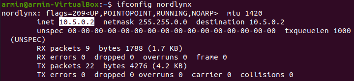

Well, Nord specifically NAT's the connection prior to any egress into 10.5.0.2 as its GW to the VPN server IP. It's transparent to the PC/devices as it's routing entries in the routing table that force the traffic to take the tunnel path. OPVN creates considerable overhead that will peg a router CPU and result in slower speeds / need for additional cooling.
What goes inside the tunnel is irrelevant here. Your encapsulated packets are still sent NATed to your ISP, which then routes them to the remote WG server. So, you still have NAT being done by the router.
