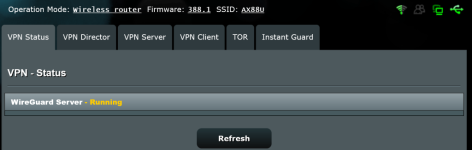

I have successfully got my two way communication between two LAN connected through Wireguard. However, the VPN Status at the server end doesn't show as connected. The VPN Status at the client end does correctly show the connection. Because everything is working well, I'm loath to mess with it and I just figure that the status of wireguard connections may not be always detected easily?
The important thing to me is it is working well, all devices in the LANs can connect to each other as if it was one big LAN with two /24 subnets.
  • FireShot Pro Webpage Capture 003 - 'ASUS Wireless Router RT-AX88U - VPN Status' - 192.168.50.1.png
  • FireShot Pro Webpage Capture 002 - 'ASUS Wireless Router RT-AX88U - VPN Client' - 192.168.50.1.png
  • FireShot Pro Webpage Capture 001 - 'ASUS Wireless Router RT-AX88U - VPN Status' - 192.168.60.1.png

I've attached pictures to show my set up. The server side is 192.168.50.0/24, the client side is 192.168.60.0/24.
The client side is also behind another router with 192.168.188.0/24 as its LAN. When my laptop is on the client network, it has access to all addresses on the server network (as well as the router network in front). When my laptop is on the server network, it can access any address on the client side (as well as the router network in front of the client side). I'm happy with this arrangement:)

1. Source ALL, destination 192.168.25.0/24, to wgc1
2. Source ALL, destination 10.6.0.0/24, to wgc1
If you choose to use 0.0.0.0/0 as AllowedIPs(client) on your site2site you will have the possibility to shift internet data, completally for selected clients, or partly for some destinations. Such rule could be
Source 192.168.50.32, destination 8.8.8.8, to wgc1
This would send google dns lookup from a single computer to be accessed via your server wan. Handy? Well, you decide.
dardar
Thanks to you both, @ThomsBe and @ZebMcKayhan, for your comments. I think you have helped me solve both of my main issues. I had been so focused on the roaming WG client configuration (both on my WG server router (192.168.25.1) and on the roaming WG client itself) that I didn't notice that the Allowed IPs for the WG client configuration on my WG client router (192.168.50.1) was set to 10.6.0.0/24,192.168.25.0/24. When I included the WG client router's own subnet in the Allowed IPs list (10.6.0.0/24,192.168.25.0/24,192.168.50.0/24), I think everything started working again (pinging from the 192.168.25.1 router to the 192.168.50.1 router and access from my roaming WG client device to devices on the 192.168.50.0/24 subnet.
I think I can now get rid of the wide-open (ALL to ALL) rule in VPN Director and add the two rules you suggest:
2. Source ALL, destination 10.6.0.0/24 (or maybe 10.6.0.2/32), to wgc1
Power is currently out at my WG server router's location (glad my wife told me, or that would have caused me HUGE confusion), so I can't test everything right now, but I think these settings are close to being correct. Thanks again!
ZebMcKayhan
Very Senior Member
Great! Altough if you are talking about AllowedIPs at your site2site client, 192.168.50.0/24 should NOT be there. This is the site local lan and packets to these ips should not be sent over the vpn tunnel at this site.
ZebMcKayhan
Very Senior Member
No, that would not make any sense. This ip is router local wg peer ip. The rules should reflect which destinations that should be sent over wg tunnel, and this is an ip local to the router. Use 10.6.0.0/24 so data to your server peer (10.6.0.1) and roaming clients (10.6.0.x) get sent over the tunnel.
philote
I've been trying to get site-to-site working via OpenVPN but it wasn't as stable & the routing rules weren't as easy to understand but this is so much easier! Thanks @Stick, @ThomsBe, @dardar, @ZebMcKayhan for your comments!
Clients of either network can reach a client on the other network, or any client on their own networks. They each access internet via their primary network. Lovely!
Site 1:
AX88U Asus Merlin 388.1
LAN: 192.168.25.1
VPN Host: 10.6.0.1/32
WG Server Access Intranet: Yes
WG Server Allow DNS: Yes
WG Server Enable NAT: No
Pre-shared Key: Yes
Allowed IPs (Server): 10.6.0.0/24,192.168.50.0/24
Site 2:
LAN: 192.168.50.1
VPN Client: 10.0.6.2/32
WG Client Enable NAT: No
WG Client Inbound Firewall: Allow
Allowed IPs (Client): 10.6.0.0/24,192.168.25.0/24,192.168.50.0/24
VPN Director Rule 1: Remote IP 10.6.0.0/24, Interface WGC1
VPN Director Rule 2: Remote IP 192.168.25.0/24, Interface WGC1
