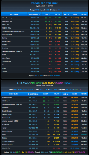

Wireless Report for AIMesh v1.3.2 - [Apr-5-2026]
I uninstalled the older version. Then, reinstalled v1.1.0.
The install correctly did NOT include that non-node AX58u.
I am not seeing any node information after the main router screen. In fact, scrolling just shows the main routers information again (although the devices are in a different order. On the main router first screen, I can toggle between IP and MAC. On the repeated next screen it won't toggle.
fixed 👍
I see only two devices and after istallation on wireless report there is nothing connected to main router (should be connected about 15 devices).

v1.1.2-comparison view enhancements
v1.1.3-better router detection

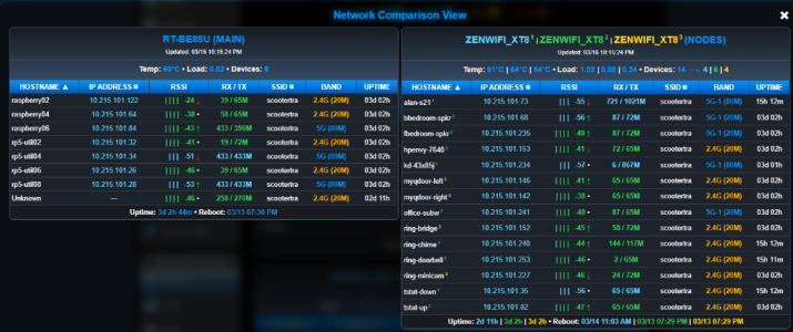

@JB_1366 thanks for the script. I installed v1.1.4, and see that none of the devices connected to my 5Ghz OR the nodes are showing up. What gives?
@JB_1366, looks like the mesh wireless interface for my setup is br0.
@JB_1366 Missed this info in the DM.
Unknown should be an xt-8 using wireless backhaul.

I have a weird thing going on (and I cannot recall if it was different or recent sorry), where the IP address on the nodes is the same?
All 192.168.63.160? This is my remote system.
[EDIT] NM, a reinstall of the script fixed it. Woot.

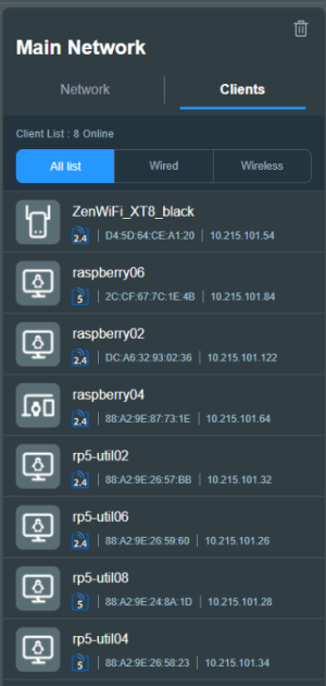

Just a minor request: Whilst manually assigned DHCPs come up well, Unknown devices just show as "Unknown", but it seems the network Map recognises them as a slightly better name (or at least a MAC address).
Would it be possible to populate the Unknown naming the same was as the Network Map does i.e. with a reported name?
That’s a great idea! @JB_1366 any chance you can change “Unknown” with the MAC address?
MAC as last resort, just whatever the network map shows would be good, i.e. priority order YazDHCP/Manually Assigned, then what Network Map shows as a fallback.
I had a bit of a discussion with RMerlin about similar naming in Sep 2025, if that helps.
Just a minor request: Whilst manually assigned DHCPs come up well, Unkbown devices just show as "Unkown", but it seems the network Map recognises them as a slightly better name (or at least a MAC address).
v1.1.5-HOSTNAME is now reporting mac address instead of Unknown
