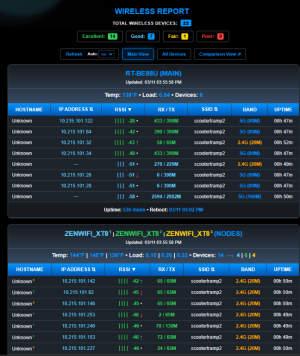

I modified the install and gen_report scripts for my ssh port choice just to check this out.
Looks very cool.

install script now autogets ssh port, updated both to v1.0.3
glad to see dynamic node scanning works with more than 2 node..cheers

Observations and suggestions …
  • The temperature is shown in deg F but I’m on deg C in my router? [EDIT] Actually applies to the date too I guess, 03/12 vs 12/03 on my machine.
  • I think just (20), (80) etc would be cleaner and neater rather than (20M) (80M) i.e. Units probably not needed here. Less clutter. If you really want, put the M (for MHz) in the header but I don't think it is needed, see next comment for why..
  • Similarly for Rx/Tx; Asus' own Network Map e.g. just shows a number for Rx/Tx, they don't even attempt to put units in the headers, so by now I think we all know what the units are (or can look it up). Less clutter.
  • These next few notes refer to the number of lines at the top of the report, which seems a wee bit top-heavy and takes away 'screen-estate' from the tables.
  • I think a single line WIRELESS REPORT: TOTAL DEVICES 19 would work better at the top, less clutter as there's 4 lines before you get to the table, then another 3 lines above each table. The Refresh and View selections need to stay at the top though.
  • I think the legend (Excellent, Good, Fair etc) would be better right at the bottom, under all the tables. Less clutter IMO. I am not sure it is even needed TBH, it is almost self-explanatory and comes up beautifully in each table.
  • I think a single line RT_AX88U_PRO (MAIN): DEVICES 8 would allow you to put Temp and Load at the bottom of each table and do away with that 3rd line at the header of each table. Maybe consider putting "Updated: 03/12 08:51:27 AM" right-justified on the same line. Then each table has one clean header line.
  • Would you allow a (different) time (and what is the default please, seems to be 30mins?) for the blinking blue up time being reported? So many little easter eggs in this thing, it's fantastic.
  • One thing that makes it a bit difficult to guess is, if you have two or more of the same node model, which ones is which. So far, @scootertramp has the high score with three identical XT8s. You can of course see which node is which by checking the devices attached to it and while the AiMesh menu has the same Model Details, it also has which room it is in. That room text would be too long, but if there was some way of having (say) a Max 5 letter suffix for each of Main, Node 1, Node 2, Node 3 e.g. MB for Main Bedroom and ANX for ANX then it would look like RT-AX86U_Pro1 (MB) | RT-AX86U_Pro2 (ANX) | RT-AX58U3 (NODES) then it would be clearer. Or in @scootertramp's case ZENWIFI_XT8 (Huey) | ZENWIFI_XT8 (Dewey) | ZENWIFI_XT8 (Louie)...
Again, when it comes to presentation, a lot is personal preference, but you asked for feedback :) .
