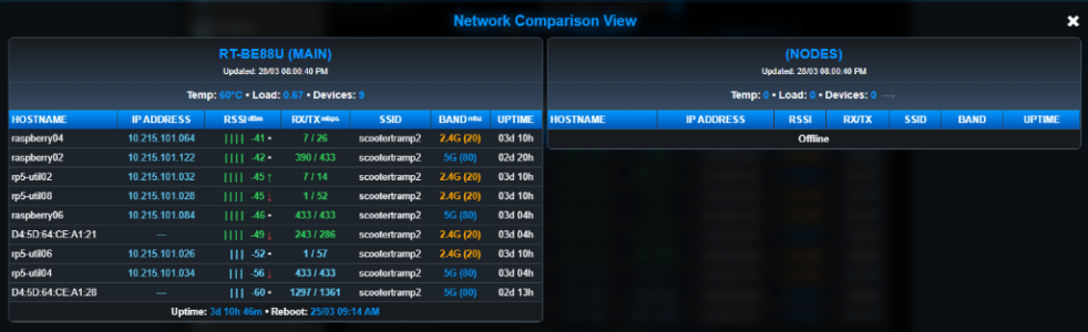

Upgraded to 1.25 and no longer seeing nodes. Ran uninstall then reinstall same result.
I as well have lost visibility to my nodes.
That’s odd. I have two independent networks and both show all the nodes after the v1.25 update.
The only oddity on update was it seemed to stop the script at a certain point but only on one network. Running wr_install again worked fine.

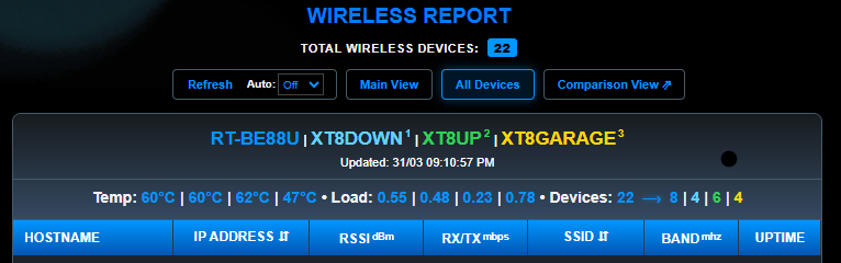

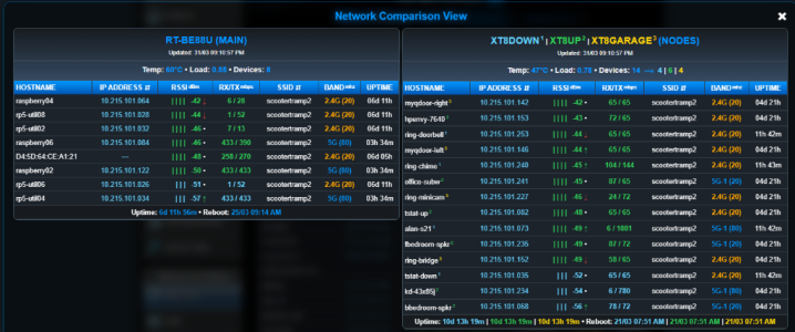

No longer seeing temp and load for each mesh node on the main view.
You can see temp and load for all devices on the all device view.
v1.2.8-fixed temp/load issue
curl -sL --retry 3 https://raw.githubusercontent.com/JB1366/Wireless_Report/main/wr_install.sh -o /tmp/wr_install.sh && sh /tmp/wr_install.sh
