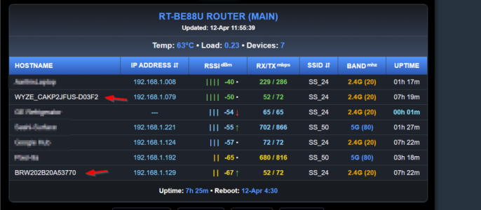

@JB_1366 reinstalled again. Based on our DMs, I know that it does not work on my ZenWifi BD4 nodes, due to the Qualcomm/Broadcom issues, but hopeful that eventually you can me it work. One question, where should I rename these? In the ASUS WebUI network map, they appear with the correct names, Wyze Driveway Camera and Brother Printer.
v1.4.0-fix Qualcomm Zenwifi BD4 detection.

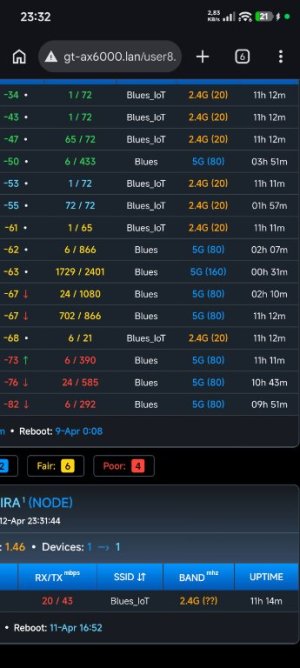

For some reason I can't figure out, I'm not getting the wireless band on node
No devices in Main router. Reinstalling and refreshing didn't helped.
I am not the dev, but maybe some quick Qs will help him spot an issue.
1. How many devices do you have? XT12 Pro plus 4 AiMesh Nodes?
2. You do have at least 1 device actually connecting to main, presumably i.e. Network Map or AiMesh shows this to be the case?
3. Do you happen to have a log of what happened after the 'initial' install? Would you be able to uninstall it, reinstall and capture that?

Would it be possible to show the client names as listed in LAN -> DHCP Server? The same names that are used on other GUI pages, like the main Network Map and AiMesh -> Clients list. (Added: Just like another post asked for, I see!)
Really nice, thanks for this!
Second that... if @bjark goes back to this even earlier post, a polite request went in then too :-). All in good time.
v1.4.1-fix hostnames, i added custom clientlist that the web interface uses. let me know how it works

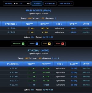

Moments ago installed this wonderful app, however both main and node show ONLY 5G band devices and no 2.4G devices
RT-AX86U for both main and node (main using merlin while node using ASUS firmware) Do have YazDHCP if that matters
Steps taken after above post
- uninstall then reinstall - made no change
- uninstall, reboot both main and node, reinstall - made no change
