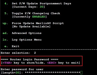

- Added messages to the "Router Login Password" prompt to let the user know how to show/hide the password string, and how to exit the input prompt.
- Sample screenshot showing additional messaging:
