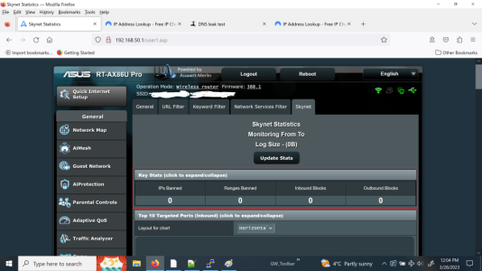

Hello,
SkyNet has lost count from withing the GUI. See the "SkyNet_GUI_20230328_1204PM_IDerase.jpg" attached file.
I logged into my Asus RT-AX86 Pro router via SSH to check things out. From within SSH the suggestions were (1) update SkyNet, or (2) contact SnB Forums. So I tried to force an update to SkyNet, and there was no connectivity.

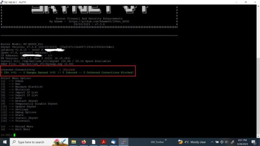

Previously I did a hard factory reset, then restored my router settings and JFFS partition from my previously save router settings file and JFFS file to get things working again.
I've done a hard factory reset with Asuswrt-Merlin 388.1 installed on my RT-AX86U_PRO, and Skynet still had "Internet Connectivity | Failed". See the "Skynet_SSH_FailedInternetConnection_20230328_801PMb.jpg" image file attached.
How can I get Skynet working again?

The Internet-Connectivity failed message means that the script could not ping google.com, github.com or snbforums.com. What happens when you try to run those over ssh? What output do you get?

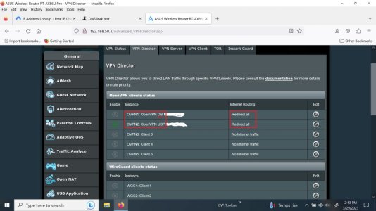

The fact that pings don’t work suggests your VPN Director rules aren’t letting the router reach the internet. You might check into that.
Yes.
I had thought that Skynet was working with a Double Open VPN client configuration. Either I'm wrong or possibly NordVPN have changed their configuration. Not sure!
You are correct because the Open VPN Client I was using with the RT-AX86U Pro had a Double server provided by NordVPN when Skynet was not able to connect using SSH. When I switched to a single Open VPN server client Skynet was able to connect using SSH. For some reason recently the RT-AX86U Pro has re-booted in the last week a few times. I may have had the Open VPN Double server to start on re-boot. Nothing wrong with a little experimenting only sometimes things can go astray.
Yes.
What I can say for SURE is that the VPN Director rules for both NordVPN's Double OpenVPN server client and the Single OpenVPN server client are the SAME.
See the "RT-AX86U_Pro_388_1_VPNDirector_20230329_243PM_IDerase.jpg" attached file.
So either the NordVPN has the 2nd server in the Double OpenVPN configuration setup differently than the single, or the simple fact there are 2 servers in the VPN connection prevents Skynet from connecting. Unless I'm missing something has to be one or the other. FWIW IIRC I do think Skynet was working previously using a Double OpenVPN server client connection. I have no way to prove since I do not track my different connections that closely.

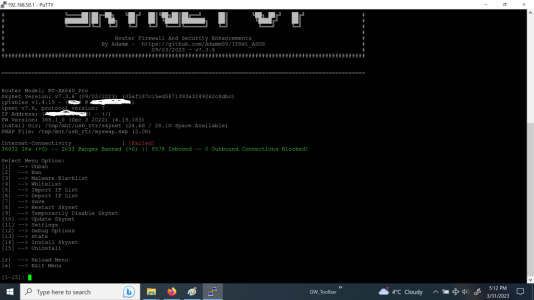

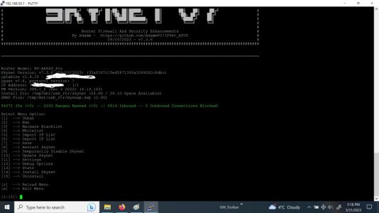

Hello,
Apparently Skynet connects differently when connecting SSH'ing into the RT-AX86U Pro. Using a Single NordVPN server AMTM > SkyNet connects no problem SSH'ing into the router. When I connect to a Double NordVPN server AMTM > Skynet can NOT connect to the Internet. Both the Single and Double are using the same parameters on the VPN Client tab from within the GUI. The counts in the GUI Firewall > Skynet tab always update after clicking the "Update Stats" button when thinking out loud probably because the stats are driven by the Swap file.
For the record see the "Skynet_SSH_SnglTCPNordVPN_20230331_518PM.png" attached file for when SSH'ing using a Single NordVPN server connecting no problem.
For the record see the "Skynet_SSH_DblUDPNordVPN_20230331_512PM.png" attached file for when SSH'ing using a Double NordVPN servers NOT connecting.
