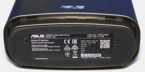

Question, where is the WPS button on your router? I can't seem to find that button at all on both nodes!
It's on the bottom to the left of the label.
