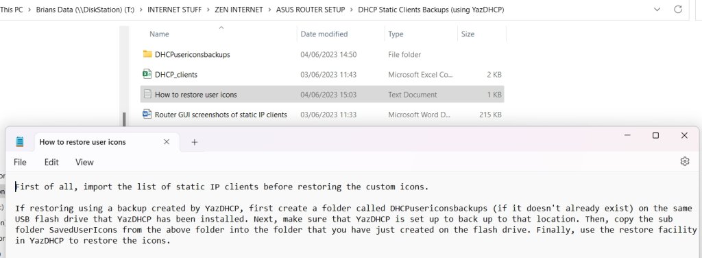

Thanks for the update. I've saved the backup file to a folder on my Synology Diskstation (where I store all my data) in case I need it in the future. BTW, if I did a full factory reset and then imported a configuration file made when using the same firmware build, would that restore all my DHCP static IP assignments as well or would I still need to set up YazDHCP again and then copy my backups back onto the USB flash drive ready for restoring that way?
I've removed the spaces from the folder name. Would this be a correct routine for restoring the static IP clients and user icons?
Yeah, you got the gist of it and the overall steps are OK although some of the phrasings seem incorrect (and yes, I know; from an outside observer, this falls on the pedantic side, but when part of your job is reading & writing functional specs & requirements documents, and dealing with other s/w & h/w engineers on a daily basis, using the standard correct terminology to try to communicate more clearly & effectively becomes automatic & second nature).
So if you don't mind my take, here is a revised version for your purposes:
1) Install the YazDHCP add-on.
2) Make sure your LAN IP address, subnet mask & DHCP IP pool range is set up to accept the IP address reservations that you're going to import next.
3) Import the CSV file "DHCP_clients.csv" which contains the list of DHCP IP address reservations & hostnames.
4) If restoring the custom user icons, recreate the same backup folder path used before if it doesn't already exist (e.g. "/xxx/yyy/DHCP_UserIconsBackups/SavedUserIcons" - including the backup files) on the USB-attached disk drive (Note: YazDHCP is *not* installed on the USB drive but on the JFFS partition).
5) Make sure that YazDHCP is set up to back up & restore the user icons to/from the specified folder path on the USB disk drive.
6) Use the "Back up & Restore" facility (either from the YazDHCP webGUI or the CLI menu) to restore the custom user icons.
